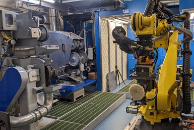

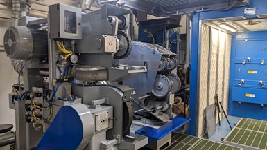

Harnessing Advanced Technology for Innovation Equipped with cutting-edge technology, the APS facility features observation and testing rooms, housing custom machines tailored for different automation approaches. These include part-to-media and media-to-part applications, facilitated by a robust FANUC R-2000iC robot arm capable of precise maneuvers.
Application engineers leverage their expertise to fine-tune variables such as spindle speeds, cycle times, and compliance, ensuring optimal performance. Through rigorous testing and data analysis, the lab refines automation strategies, drawing from years of industry experience.

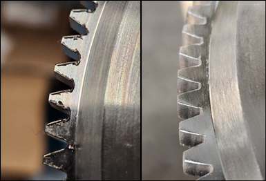

Success Stories in Automated Deburring One notable achievement involves automating the deburring of gear teeth, a notoriously intricate task. Mike Shappell, Senior Application Engineer, led the development of a two-step process involving abrasive flap wheels and Sunburst bristle disc brushes.
Careful calibration of spindle speeds and brush engagement ensured precise material removal without compromising part tolerance. By stacking bristle brushes and optimizing rotational directions, the lab achieved exceptional efficiency, reducing cycle times to a mere 20 seconds per face of the gear.
