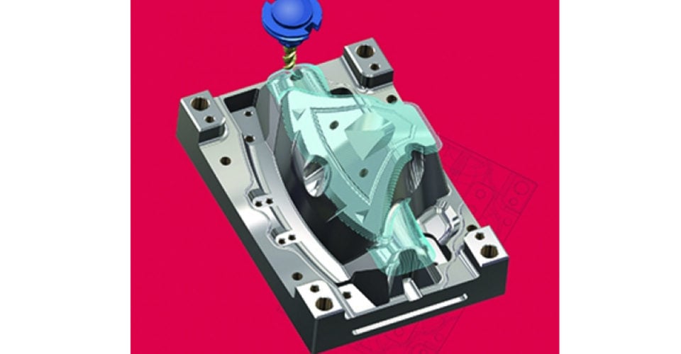

Maintaining climb and conventional machining is crucial for surface finish and tool life. Controlling Climb and Conventional Cutting for Morph, Parallel, Unified, Project Curve, and Flow toolpaths now provide constant control of climb or conventional cutting even while in complex areas that would require use of both sides of the tool.
A Mill part being programmed with a toolpath on a red background.
