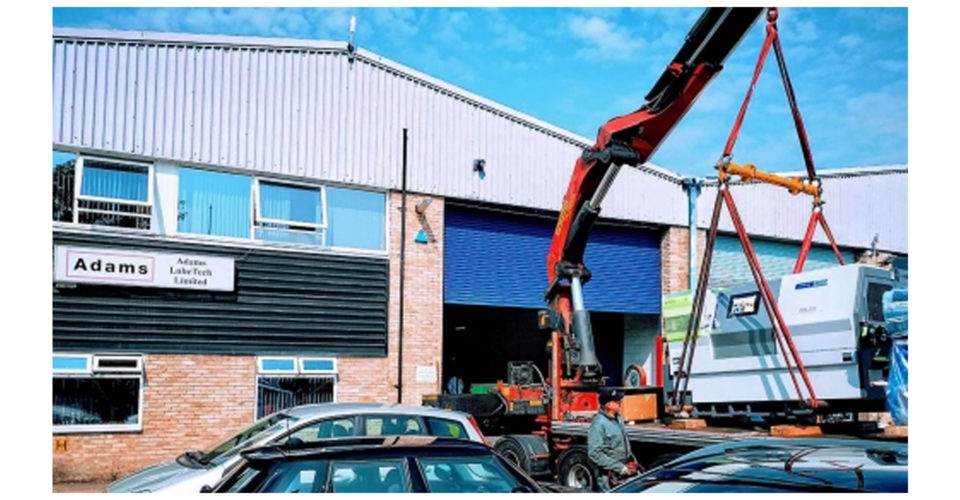

Consistently rising sales worldwide meant the company needed extra production capacity. So in early 2020 the firm purchased its first lathe from Citizen Machinery, a fixed-head Miyano BNJ-51 turn-mill centre, to machine not only rotational parts but also components that were previously produced on a manual mill or a power press.
