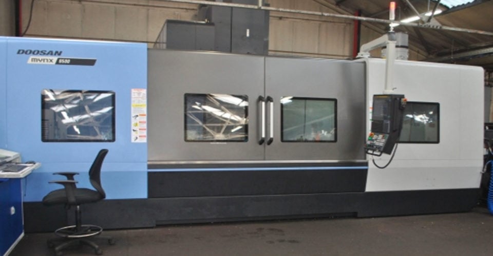

Mills CNC, the exclusive distributor of Doosan machine tools in the UK and Ireland, has recently supplied Stourbridge-based HCM Engineering Ltd., a progressive and innovative precision toolmaker and die-casting process technology specialist, with a new large-capacity 3-axis vertical machining centre.
The machine – a Mynx 9500/50 – is a robust and rigidly-designed and built box-guideway 3-axis machining centre ideal for heavy-duty machining operations (including interrupted cutting) and long machining runs. The machine is a proven performer capable of delivering high (and fast) material removal rates and super-fine finishes.
“It is”, according to Mike Hanson, HCM’s Operations Managing Director, “a versatile machine: a real all-rounder.”
The Mynx 9500/50 was installed at the HCM’s 12,000 sq. ft facility in Lye in February 2021 and is being used to machine complex, high-precision die-cast mould tools for a number of leading OEM and Tier One customers – predominantly, but not exclusively, from the automotive sector.
The die-cast mould tools machined on the new Mynx 9500/50 are complex and are characterised by their intricate and high-precision features (i.e. thin walls, ribs, tapers, single and/or multiple cavities etc.)…and increasingly by their (large) size.
Specific mould tool elements machined on the Mynx include 3D ‘component’ forms and features, 2D plates, mould inserts, cores and slides etc. They are made from hardened tool steels and are machined to tight geometric tolerances (0.025mm) and high surface finishes, and to exacting quality standards.

The Mynx 9500/50 is a large-capacity machine with an impressive work envelope (X-axis – 2500mm; Y-axis – 950mm; Z-axis – 850mm) that can accommodate workpieces up to 3,500kg in weight.
The machine’s 2500mm x 950mm work table is being used by HCM to machine large (single) workpieces as well as multiple (smaller) jobs. These are/can be machined in a single set up and, such is the reliability of the Mynx 9500/50, can be machined unattended – overnight and over the weekends.

The machine’s powerful, high-torque and thermally-stable BT50 built-in spindle (22kW/10,000rpm – 452N-m), with its BIG PLUS dual contact face and taper configuration, delivers excellent high-speed and high-accuracy cutting performance, even when machining ‘difficult-to-machine’ materials and when being used for long machining runs.
Continues Mike Hanson:
“The Mynx’s rigid design and build combined with its advanced spindle technology (including through-spindle-coolant capability) enables us to ramp up feeds and speeds and to take aggressive depths of cut – all of which help reduce cycle times.
“The machine’s technical prowess, in addition to its 40-position servo-driven ATC with a 2.5 second tool changeover time, gives us the ability and confidence to run the machine (unattended) overnight and over the weekends.”
