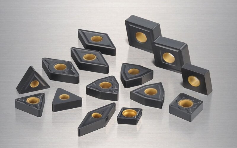

Kyocera’s latest CA410K and CA415K chemical vapor deposition (CVD) coated carbide grades are engineered to deliver superior performance, durability, and reliability across a broad spectrum of cast iron machining applications. Targeted at industries such as automotive, heavy machinery, and agriculture, these new grades combine advanced coating technologies, robust carbide substrates, and a diverse range of chipbreakers to provide both fracture resistance and long-term stability.
The CA410K grade is designed for continuous machining operations, offering exceptional wear resistance at elevated cutting speeds. It excels in stable cutting environments where maintaining tool integrity and precision is critical over long production cycles. On the other hand, the CA415K grade is developed specifically for interrupted and heavy-interrupted machining conditions. It provides outstanding cutting stability, making it ideal for roughing operations and situations where sudden load changes and shocks occur. Together, the two grades cover a wide range of cast iron machining needs — from high-speed finishing to demanding roughing applications.
Kyocera’s innovative coating structure plays a crucial role in balancing durability and performance. The CA410K/CA415K series features optimized rake and flank face properties that effectively manage both wear and fracture resistance. The rake face is treated with a black alumina layer that is thick, uniform, and engineered to minimize wear, suppress delamination, and prevent fracturing. Meanwhile, the gold flank face features a hard surface layer, an alumina layer, and a TiCN layer, which together enhance wear resistance and provide an easy visual cue for identifying used edges.
Beneath these advanced coatings lies a tough carbide substrate that enhances adhesion, reduces delamination, and resists cracking — critical features for maintaining tool life in harsh cutting environments typical of cast iron machining. This multilayered design ensures consistent tool performance even under challenging thermal and mechanical conditions, allowing manufacturers to achieve higher productivity and reduced tooling costs.
A standout feature of the CA410K/CA415K series is its extensive range of chipbreaker options. From finishing to roughing operations, users can select from various chipbreaker geometries tailored to different machining requirements. This flexibility ensures optimal chip control and cutting efficiency, regardless of the operation type or material hardness. Additionally, Kyocera’s mesh processing technology improves coating adhesion and enhances chipping resistance, resulting in longer tool life under both high-speed and interrupted cutting conditions.
By integrating material science expertise with precise coating and geometry design, Kyocera has positioned the CA410K/CA415K series as a versatile and high-performance solution for cast iron machining. These new carbide grades not only deliver improved wear and fracture resistance but also help manufacturers optimize productivity, reduce downtime, and ensure consistent machining quality across diverse applications.
