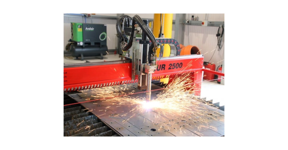

As part of the collaboration, Lantek has worked closely with the engineering team at Kerf to perfect its UltraSharp technology which delivers high quality parts with a square edge, better quality edges and 1:1 hole sizes, for example, a 5mm hole in 5mm material, a capability which would previously have been impossible on a plasma machine. For the user, this capability makes it possible to use much lower cost plasma technology rather than laser technology to manufacture parts and is especially effective for thicker components. Dan Taylor adds, “The UltraSharp technology involves internally enhanced software protocols, accelerating and decelerating the torch dynamics on tight contours and holes, controlling the power, gas pressure and flow, amongst other things, and also automatically selecting special lead in and lead out configurations. The result is a constant and true arc with no lag between the top and bottom of the material being cut. All the parameters required to achieve this are built into our technology tables making it easy to achieve high quality components direct from the CAD data.”
One of Kerf Developments’ customers, Pressed Flights based in Littleborough, manufactures screw conveyors.  The shape of the screw in its flat state is complex and, in many cases, varies along the length of the screw depending on the material being transported.
Previously, these parts were subcontracted for laser and waterjet cutting. Now, the company has a Kerf RUR2500p machine with UltraSharp cutting technology and Lantek’s software and carries out all the cutting in house achieving ± 0.25mm general tolerance. Mark Cryer, Managing Director at Pressed Flights says, “It is one of the best investments we have made. We transfer CAD data directly into Lantek, nest the parts for best yield, easily and quickly generating the CNC program. The Kerf UltraSharp plasma is very reliable producing augers which are spot on in size, it is a vital part of our operation. After sales service is excellent from both companies.”
