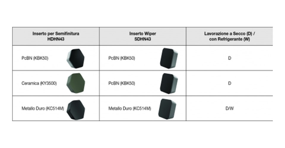

The KCFM 45 uses a combination of hexagonal semi-finishing inserts in the fixed pockets together with square finishing inserts in the adjustable pockets with cartridges.
Recommended insert configuration for dry and wet machining.
Carbide inserts: Ideal for machines with lower spindle capabilities.
Ceramic inserts: For highest productivity, ideal for semi-finishing.
PcBN inserts: For highest productivity, ideal for fine-finishing.
