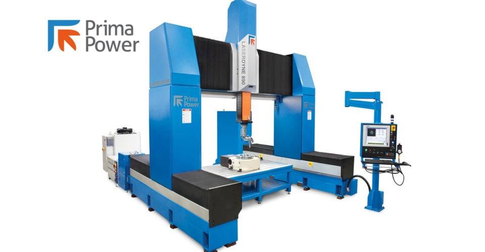

Champlin, Minnesota: Early users asked for it — Prima Power Laserdyne made it happen — the renewal of the 890 LASERDYNE® Multi-Axis Laser Processing System. This is an all-new LASERDYNE 890 system with powerful and efficient fiber laser, the latest highly flexible BeamDirector®, and the S94P control loaded with a full portfolio of Smart Techniques™ operating capabilities.
With all of these enhancements and a large  96 x 72 x 36 inch (2440 x 1830 x 400 mm) work envelope for the X, Y, and Z axes — along with the latest BeamDirector and a complete flexible five axis work envelope — the modern LASERDYNE 890 is designed for today’s challenging large part welding, drilling and cutting processes. Its spacious gantry design configuration has proven useful in fixturing large and complex parts, allowing for faster and more efficient high-value part set-up and laser processing.

The LASERDYNE 890 includes the latest generation of the BeamDirector. It provides rotary and tilt (fourth and fifth) axes of laser beam motion. Rotary (C axis) motion is 900 degrees about the vertical axis while tilt (D axis) travel is ±150 degrees about the horizontal axis.
The Prima Power Laserdyne BeamDirector features direct drive design, optical encoders for high accuracy (+/- 15 arc-second) and repeatable, high assist gas pressure and flow, and adjustable mirrors for easy and accurate beam alignment.  The high capacity direct drive design eliminates gears and belts for higher accuracy, allowing greater travel and reach over zero offset style wrists.  (Photo Two)

 Robust, Rigid LASERDYNE 890 Structure
A true workhorse, the new LASERDYNE 890 incorporates a rigid base with heavy-duty steel weldment construction and robust motion system with precision machined surfaces, and reliable motion system.
