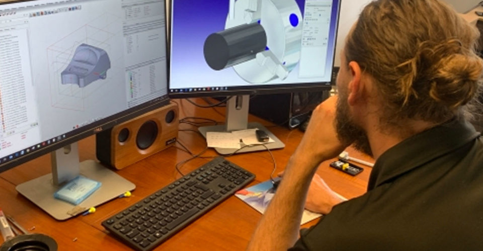

From a collision avoidance and security perspective, Mr Goldsmith states: “One of the beautiful things about hyperMILL® is that when you are putting all of your models together, you can build up a library of all your machine tools, your fixtures, vices, your chucks and your cutting tools. You can put all of this information into the system and it will give you a 100% accurate picture of what is going to happen before you push the button. This allows you to avoid collisions and highlight things you might have missed.”
With three seats of hyperMILL® and a significant investment in 3 to 5-axis machining as well as several CNC turning centres, Mr Goldsmith alludes to the capabilities of hyperMILL® with regards to the company’s turning activities, saying: “hyperMILL® has had a major impact on turning operations. Basically, it is now allowing other people to undertake programming tasks. Before, all the programming for turning was done on the CNC consoles on the shop floor. This is very time consuming and when the machines are being programmed, they are not running or making any money. Now that we have hyperMILL® we can program all of the turning in the office on hyperMILL® whilst the machine is running. Once the parts are programmed in the office, we can just pop the programme into the machine, run it through to make sure it works and we’re good to go. This has drastically reduced non-cutting times in the CNC turning department by virtually eliminating on-machine programming.”
