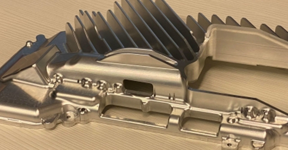

Steve Holmes, Managing Director at Pro-Cut Precision Engineering recalls: “We purchased hyperMILL® a little while ago actually, and Alex had done the training, but we naturally kept falling back to our existing provider due to tight deadlines and several other factors. For a little while, hyperMILL® was just sitting there, but then this one particular part came along! It was a challenging aluminium electronic casing part that was outside the scope of our current CAD/CAM system. So, we decided that this was the part that we begin with, where we jump in and manufacture with 5-axis simultaneous hyperMILL® machining. This is the first part that we produced using hyperMILL® and it was absolutely bonkers – and we only had two weeks to complete the 3-off batch of parts.”

As the programmer that was tasked with creating the program for the complex aluminium electrical housing part, Alex highlights the features that stood out with remarkable ease of use: “The 5-axis and the Z-level finishing is very good with this software. You just have to click on a surface, and hyperMILL® will machine that surface. Once you understand how it works, it is very easy to actually use and get up to speed with. It means you can quickly reach competence level where you can do complex work much easier.”

Taking a closer look at the electrical housing part, Alex says: “For the first operation we held the part in a Lang workholding vice, machined the top and all of the internal sections as well as the outside profiles. This first operation alone required upwards of 25 tools and the hyperMILL® tool library keeps that information ready, so you can access it for other upcoming jobs. This makes the whole process of programming a lot quicker and easier.”
Discussing potential collisions and tool path and strategies, Alex says: “With the tool library you can set up your tool length and how far the tool is sticking out of the holder, that data is used when hyperMILL® is calculating. This avoids collisions and also tells you how much further the tool needs to stick out to avoid a collision.”
Following the first operation, the aluminium housing was turned over for machining on the opposite face. Highlighting this, Alex says: “We made a fixture plate to locate on the inside of the component and we threaded the tabs to pull down the periphery of the part. On the second side of the part, we used 6 tools. Programming the part took a couple of days. However, now that I have undergone a steep learning curve and I know what to do, programming similar future components would take significantly less time – we could probably program this part in half a day now.”
“Previously, this part would have been very difficult to program without hyperMILL®. The second side of the component would have undoubtedly made our previous CAM system crash a lot as there is a lot of information and a lot of code being produced. With hyperMILL®, we have machined the complete component in just 15 hours. Now that we have used this very complex part as the first push to get ontohyperMILL®, we are very pleased that we are using it effectively for all of our parts.”
