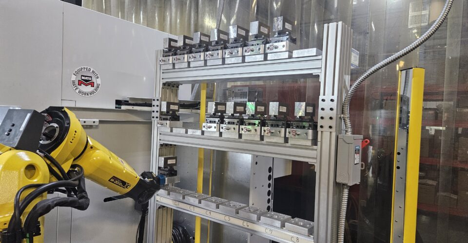

In addition to its benefits in traditional machining, Mate’s workholding solutions have supported United Machine’s automation efforts. The company recently installed a Haas UMC-500 with a robot pallet loader and upgraded its system from 15 pallets to 40 pallets—all equipped with Mate vises. This automated cell now runs lights-out overnight, increasing operational efficiency.
