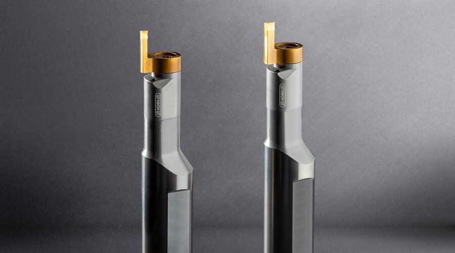

Horn USA Inc. has introduced the Mini 114 system, a grooving tool that offers exceptional process reliability and versatility for turning and copy turning axial grooves. Designed for precision machining, the tool is suitable for a wide range of industrial applications, ensuring reliable performance and excellent surface finishes.
The Mini 114 system supports a face grooving depth of up to 10 mm, making it ideal for intricate axial machining tasks. A standout feature of this system is its compatibility with standard axial holder systems, eliminating the need for special toolholders. This allows users to integrate the tool seamlessly into their existing setups, saving both time and costs.
Horn offers the EG55 carbide grade grooving tools in three cutting widths—2 mm, 2.5 mm, and 3 mm. The system accommodates a grooving diameter range of 14 mm to 34-36 mm, depending on the specific insert type. These features make it versatile for small-diameter machining and precision applications.
The face-screwed inserts of the Mini system are a flagship product in Horn’s lineup. They are suitable for various machining tasks, including turning, milling, boring, internal grooving, and face grooving. Paired with low-vibration carbide toolholders, the inserts ensure process stability and deliver superior surface finishes, even during operations with long overhangs.
The Mini 114 system includes a comprehensive portfolio of inserts to meet diverse machining needs. The range covers various sizes for internal diameters, different geometries, and substrates. Additionally, CBN and diamond-tipped insertsare available for increased wear resistance and extended tool life, enhancing performance for demanding applications.
