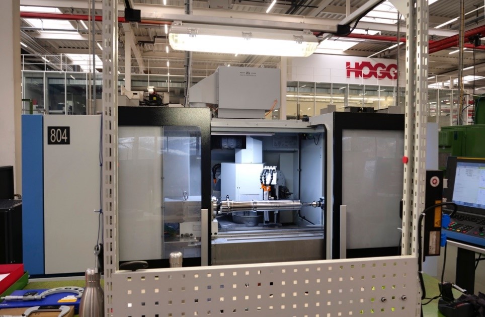

A total of seven grinding machines are located in the grinding area, including two Kellenberger universal cylindrical grinding machines, one of originally two KEL-Varia and, as the most recent addition, aKELLENBERGERK100, which was purchased in 2021. The KEL-Varia universal cylindrical grinding machine – the predecessor of today’s premium Kellenberger K1000 series – stands for the highest machining and surface quality. Its high static and dynamic rigidity and stability form the basis for high precision and high productivity. The performance spectrum of this machine is geared towards the quality requirements of precision manufacturing of prototypes as well as small and medium series.
When purchasing the new cylindrical grinding machineOnly Kellenberger was contacted. Stefan Kaufmann explains the reasons for this: “We attach great importance to considering suppliers from the region whenever possible. The advantage of geographical proximity for us is, of course, that service is available quickly when needed. However, we already do a lot with KEL-Remote, Kellenberger’s online service module. We’re very satisfied with it.”
TheKELLENBERGERK100 is a modular platform solutionwith which different machine concepts can be realized with strong customer orientation.The machine is available with center distances of 1000/600 mm and a center height of 200 mm and is designed for workpiece weights up to 150 kg. The high drive power of the grinding wheel ensures increased productivity, while the newly developed Z-guide ensures high profile accuracy. The C-axis with direct drive provides greater precision in non-circular grinding. This is very important for workpieces such as cam disks, which are manufactured at Högg.
Typical workpiece: Cylinder during grinding on the KELLENBERGER K100. Material: hard-chrome-plated steel, batch sizes typically 1 to 100
The technical highlights of the machine include an innovative compact grinding head (10 grinding head variants, 11.5 kW drive power, 500 mm wheel, up to 63 m/s, HF spindles for internal grinding including diagonal and tandem arrangement), a collision-free universal head with three tool and one measuring position as well as a new measuring probe arrangement without a swivel mechanism for increased measuring accuracy.The reinforced casing allows for the largest grinding wheel diameters for internal grinding (up to 125 mm).
Polymechanic Andreas Hausmann has been working for the company for over 40 years, starting as an apprentice in 1981 and operating and programming Kellenberger machines, among others. He says: “AtKELLENBERGERWe were impressed not only by the K100’s machining quality with an accuracy of 2/100ths, the linear guides, and the good thermal conductivity, but also by the improved accessibility to the well-structured work area and the wider spacing between the spindles. The grinding head, equipped with two internal grinding spindles, is also better arranged.
The KELLENBERGER K100 is equipped with the new Fanuc 31i CNC control with 19″ touch screen. AndreasHausmann appreciates the ease of programming, which is possible directly on the machine with the new BLUE Solution software developed by Kellenberger: “Due to the part specifications, we usually program externally using Kellenberger’s BLACK CAM Solution software, which was developed specifically for non-circular grinding. The control also features a scrap minimization function, which identifies influencing or disruptive factors during a test run.”
TheThe KELLENBERGER K100 is ideally suited for a wide variety of automation solutions. However, even though approximately 30% of all machines at Högg are already automated, they don’t see any need for the KELLENBERGER K100. “That may change, but at the moment, the workpieces don’t allow for it,” says Stefan Kaufmann.
The KELLENBERGER K100 at Högg is configured with a center distance of 1000 mm and a center height of 200 mm and is equipped with a standard tailstock. A synchronized tailstock is available as an option. The machine also impresses with its easy access to the spacious work area.
