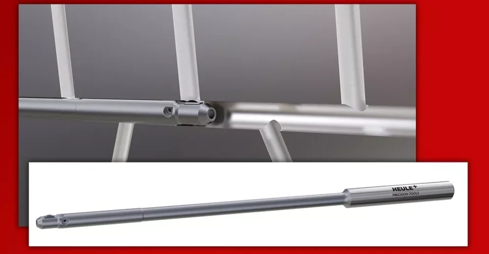

Heule Precision Tools has launched the SNAP-X, an advanced deburring system designed to tackle one of the most demanding challenges in machining—deburring main bores with multiple intersecting cross holes. Built on the trusted SNAP platform, the SNAP-X provides a precise, automated solution that minimizes cycle time, enhances consistency, and eliminates the need for manual deburring or secondary finishing operations.
The SNAP-X system efficiently deburrs cross bores of varying diameters and angles directly through the main bore in a single continuous pass. It is equipped with two blades that cut in both forward and reverse directions, ensuring complete and uniform deburring across all intersections. A guiding edge and gliding section prevent potential damage to the main bore, maintaining surface integrity even in complex geometries. This feature is particularly valuable in high-precision applications where surface quality and dimensional accuracy are crucial.
Ease of maintenance and reduced downtime are central to the SNAP-X design philosophy. Blades can be replaced quickly and easily by hand without the need for tools, making it ideal for high-volume production environments. The system’s simple and robust structure—with only a few components and a single screw—offers high durability and reliability under continuous use.
Each SNAP-X tool is custom-engineered to meet specific application requirements, making it well suited for components such as drive shafts, transmission parts, and hydraulic blocks that contain multiple cross bores of different sizes and angles. The tool performs efficiently on configurations with bore diameter ratios up to nearly 1:1, ensuring flexibility and consistency in a wide range of machining operations.
At the core of the system lies a radially supported, spring-loaded blade that automatically adapts to various bore diameters. During operation, the blade penetrates each cross bore while feeding forward, deburring effectively regardless of the bore’s size or position. When spindle rotation is reversed, the tool performs a second deburring pass as it exits the main bore, ensuring complete removal of burrs on both entry and exit edges.
The design includes a guiding edge that retracts the blade safely into the tool body as it leaves a cross bore, protecting the main bore from scratches or damage. To further enhance performance, the tool body features a recess in the feed direction that prevents burrs from being forced into cross bores. For extended reach or deep-hole applications, extra-long tool versions are available in multi-piece construction, ensuring stability and accuracy during operation.
Proper alignment and guidance are critical to the performance of the SNAP-X, particularly in long bores where stability is key. Heule recommends the use of adequate chamfers and precise positioning before activation to guarantee optimal results.
