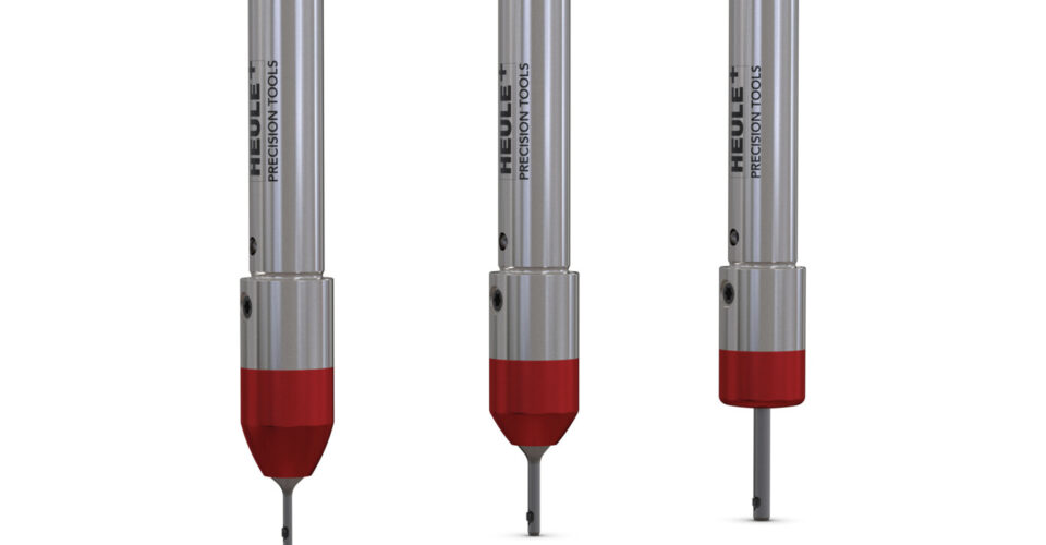

Heule Precision Tools introduces the DL2 deburring tool, designed to provide exceptional performance for CNC operations on bores ranging from 1.00 to 2.1 mm across a variety of materials, including steel, stainless steel, titanium, aluminum, and composites. The tool’s compact and robust design ensures high efficiency and reliable deburring, even on slightly uneven bore edges.
Key features of the DL2 include a simple, four-component construction with an integrated carbide blade and spring unit, offering consistent spring tension for precise guiding and cutting forces. Its internal blade cooling system ensures optimal coolant delivery directly to the cutting edge, enhancing performance and process safety during high-volume machining.
The DL2 is ideal for precision micromachining applications, including deburring watch cases and medical components. The tool is available in common sizes for quick use and requires no rotation direction change or spindle stoppage during machining, ensuring seamless operation across a range of applications.
