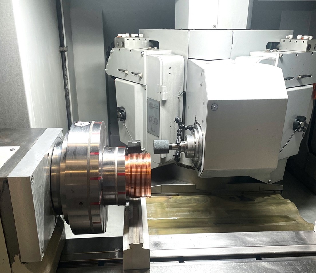

Internal grinding of a workpiece with problematic material combination

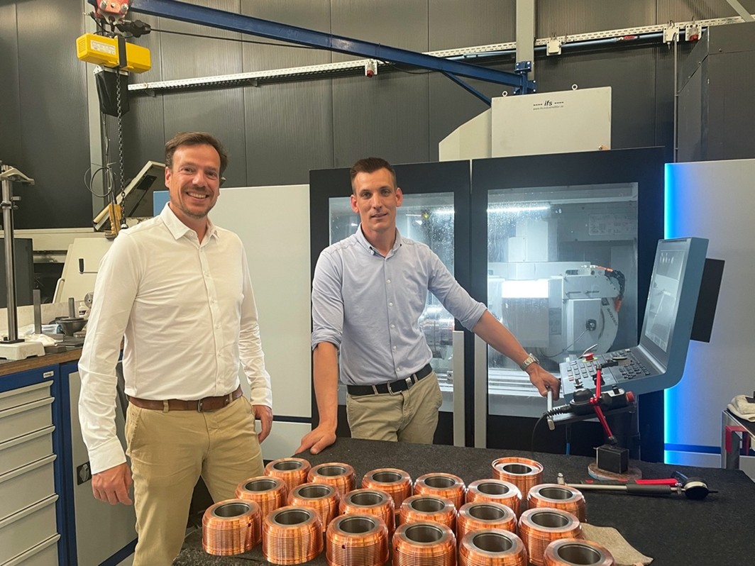

Challenging workpieces are part of our daily business, such as the current machining of a component made from a combination of copper and cast iron. The required roughness is < 0.15 µm. “We could also achieve 0.05 µm, but that’s not necessary in this application,” explains Randy Gevers. However: “Cast iron is a very porous, brittle material; the grinding stone clogs up very quickly and must be dressed continuously, but not too often. It’s essentially about finding the right balance. The more experience and sensitivity a grinder has, the more precise such a workpiece will be in the end. Incidentally, this is very expensive due to the material combination and the upstream processes such as turning, milling, and EDM. The grinding process must therefore be perfect right the first time.”
