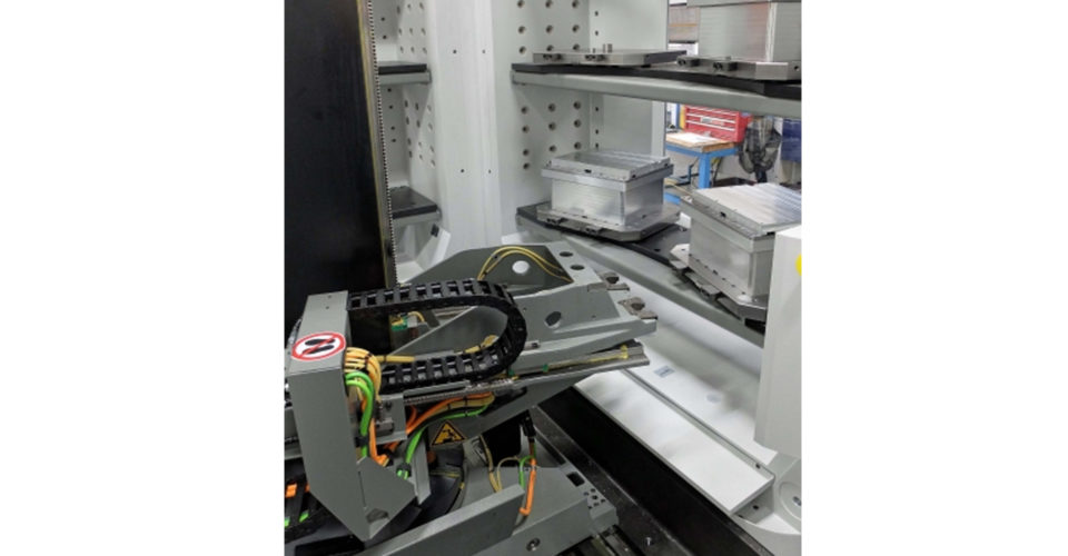

The first machining centre built by German manufacturer Hermle to be installed at a Hyde Group company has been operating around the clock since April this year (2019) at Stoneswood Precision Components, Dukinfield. The C 400 5-axis vertical machining centre (VMC), supplied by sole agent Kingsbury , has been automated with the machine manufacturer’s HS Flex pallet storage and retrieval system to enable unattended subcontract production overnight and at weekends.

The specification of the Hermle cell includes an 18,000 rpm / 20 kW spindle, extended tool capacity from the standard 38 pockets by the addition of an 88-position magazine for HSK-A63 tools with breakage monitoring and measuring included, a Heidenhain TNC 640 control, 850 x 700 x 500 mm working area, +91 / -139 degrees trunnion swivel, 500 x 400 mm pallet size and capacity for 12 of them on two levels in the HS Flex store, which is served by a three-axis pallet handling unit with rotary, lift and linear motions.
The store is controlled and managed by Hermle’s proprietary Automation Control System, which enables smart order management via a touch panel. It is currently being interlinked with an MES (manufacturing execution system), recently installed in Dukinfield by Forcam, which is compatible with Stoneswood Precision’s SAP ERP (enterprise resource planning) software. It allows production orders to be sent directly to all machines for improved job sequencing, leading to optimised production output. The resulting provision of enhanced data, including of machine utilisation, is taking the subcontractor’s operation further along the road of Industry 4.0.
