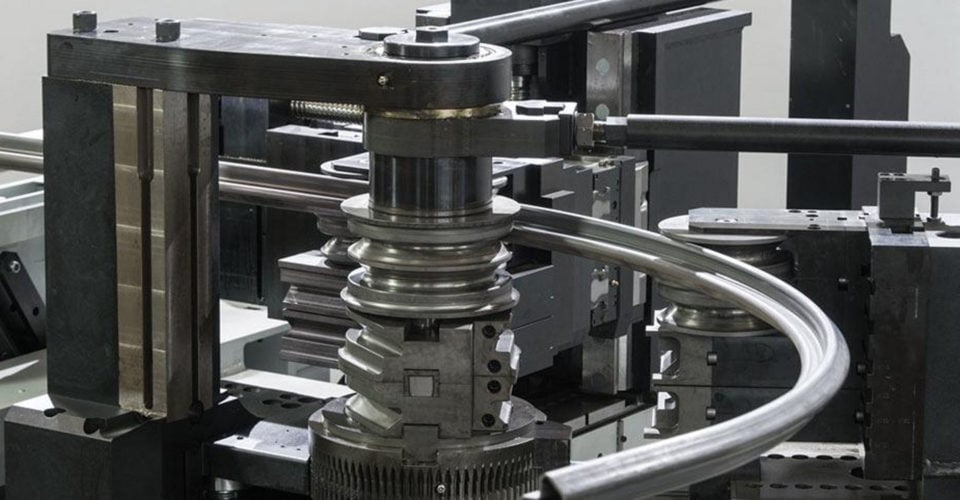

“You have to figure out the best approach to support the material, to keep it in the shape that you want it,” said Searles. “Sometimes that’s done with hard tooling, where the tooling is just on the outside surface, or you’re using a mandrel to support it. Other times that’s not enough. In some cases, fabricators may need to use consumable materials in the gaps of the open shape in order to maintain it. Once bending is complete, these consumable materials can be stripped out. This can be an expensive process but necessary for these types of applications.”
Searles gives the example of a window frame. As the frame shape, which is usually made of aluminum, is bent, the open feature where the glass will go needs to be maintained, so using consumable materials in this gap will keep its structure through the bend.
“Special tooling is necessary,” said Knobloch. “Getting good tooling that is designed well will make a difference in the feasibility of bending the profiles. With round tubes or square tubes, the tooling is fairly easy to maintain using a turning process. It’s less expensive and less time-consuming to maintain these tools. But for special profiles, a shop may need to use a milling process to maintain the complex tooling that is required. It’s important to consider that this can be more cost-intensive and time-consuming.”
The tooling for these special profiles needs to be able to open and close, according to Searles. A split die will give fabricators the ability to open the tooling and insert the material to sit within the tool that closes around it. The tooling may need to open in more than one location within the section, depending on the profile design. Working with reputable tooling suppliers to develop the best design is a good starting point.
