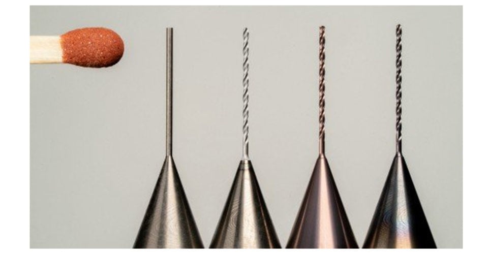

Indeed, carbide drill bits laser-fabricated by the machine can subsequently be coated (by the physical vapour deposition process) with a single layer of TiAlN or AlTiN alloy and the coating processing method is the same as that applied to ground cutting tools.

In terms of micro drills, for instance, the advantages of using laser technology compared to conventional techniques, include:
  • [] Diameter-to-length ratios of up to 1:20
  • [] Ability to process additional small features such as tip thinning and tip chamfers
  • [] There’s no tool breakage and no need for a steady-rest because lasering is a force-free process
  • [] The process enables a high degree of geometrical flexibility since brazed plate-based tools and spiral tools can be fabricated without re-tooling.
On spiral micro tools, the lasered surfaces are homogenous and do not show any form of directional feed marks compared to the ground surface. Furthermore, the surface quality of the lasered WC surfaces is 20% better than the ground WC drill bit.
For lasered PCD surfaces, excellent surface quality is also achieved and in general, lasered spiral tool surfaces – regardless of material – exhibit surface roughness values for Ra and Rz of <0.25 micron and <1.5 micron, respectively. Cutting edge radii are typically ≤5 microns and are symmetric with a K-factor typically equal to 1±0.2. In terms of diameter stability, a tolerance of ±0.005 mm can be achieved in a 12-hour production run in climatic-controlled conditions.
