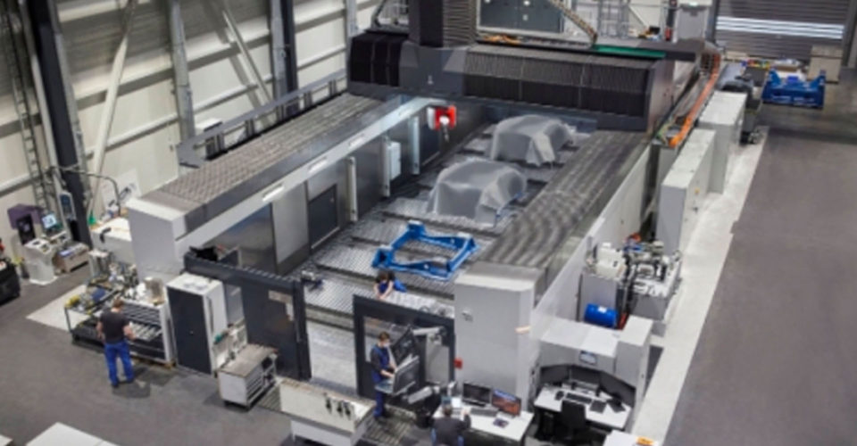

Thanks to the swivel fork head, even complex contours can be machined quickly and precisely.
“We actually needed two types of machines – a portal machine with a movable table for very large components and a dynamic gantry machine that can be set up during operation for night, slim manned shifts, among other things,” explains the managing director. “An automotive company would simply use two types of machines, but we cannot afford that.” Since Bielefeld has always been “ready to listen” in the past 20 years, Schwab once again drove to the Starrag plant. There, the experts for large-scale machines suggested combining the two machine types Droop+Rein FOGS and TF into a completely new machine concept. This led to the creation of the Droop+Rein FOGS HD, a powerful, precision-cutting high-gantry machine (X-axis: 591 in. (15,000 mm); Y-axis: 197 in. (5,000 mm); Z-axis: 79 in. (2,000 mm)) with extremely high torque (1,770 ft-lb to 5,532 ft-lb (2,400 to 7,500 Nm)) and fast, dynamic axes. CONCAD is not only pleased with the new dynamics: The FOGS HD is about 20 to 30% faster and more economical than a portal machine. In addition to the possibility of unmanned production, the option of parallel set-up in the machine at peak times is also a plus for the newcomer. CONCAD already uses them intensively, as an on-site visit showed: The job shop used the entire length of 49 ft (15 m) to simultaneously process an aluminum housing, a workpiece from the marine area and a deep drawing tool. This is made possible by the safety zones with a partition wall.
