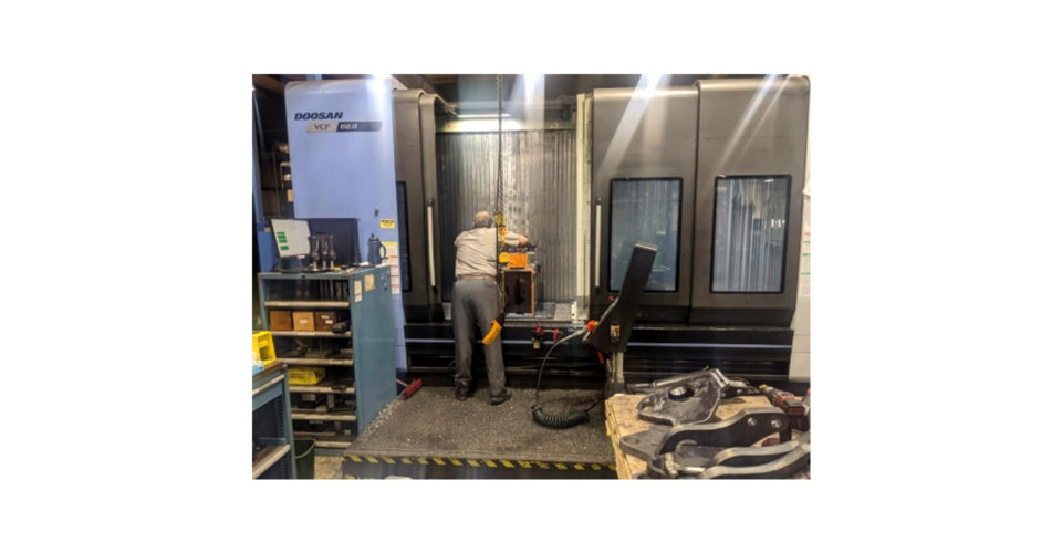

Link’s relationship with Ellison Technologies started when Derek Poppema, the company’s Manufacturing Engineer overseeing CNC machines, attended his first IMTS show in Chicago. He told Tim Petersen, his account manager, that the business was evolving rapidly and he was beginning to see a need for more advanced equipment on the shop floor. There was some discussion about whether a horizontal or a vertical mill would be a better choice. After consulting with Tim, Derek suggested the management team consider the VCF 850LSR, an HSK63 taper, large vertical machining center with a 120″ wide table and rotating B-axis spindle head.
“This machine allows the use a partition on the 140” long table, creating separate work zones. We use this to our advantage, much like a pallet changer, where an operator can be unloading/loading parts while the spindle is machining in the other work zone, “ Derek said. “Take out the partition and you have the ability to work on very long parts. In our case, that means truck axles.”
With some creative fixturing and the use of the B-axis spindle head, Link could now process multiple faces on the axle part, something they weren’t able to accomplish before on the smaller vertical machining centers they were using. This allowed them to cut down on total cycle time as well.
“Not only that, we also relocated some casting parts to the VCF and cut cycle times in half,” Derek said. “We now run four parts in 30 minutes versus an hour.”
