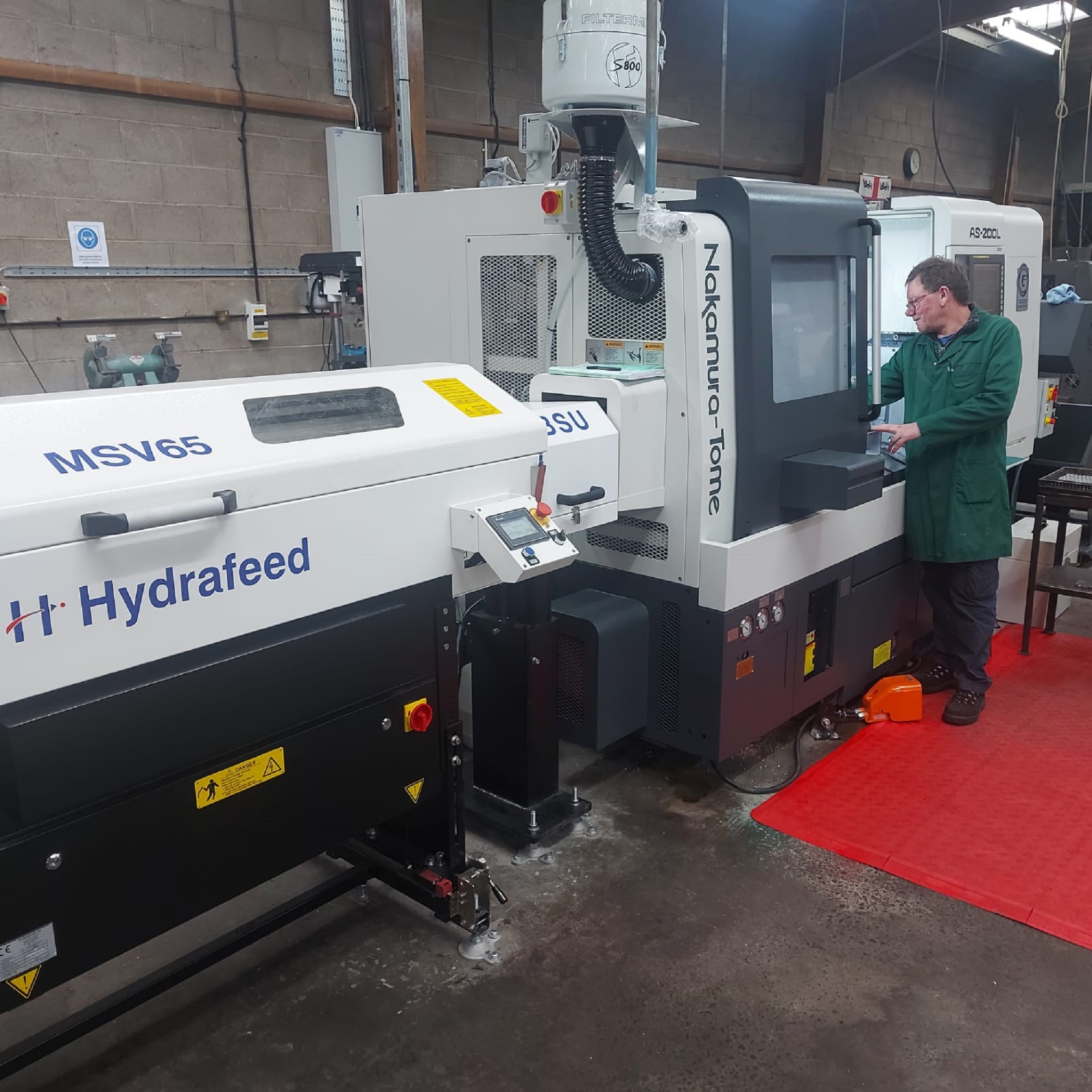

During Covid, the manufacturer reflected upon its position, as Managing Director Mr Richard Guest says: “We reviewed our processes and ageing plant list and instigated a plan for investing in new technology. We machine a lot of parts in batches that can vary from 4 or 5-off through to 50, 100 and beyond, and our turning centres were all single spindle machines. This meant that most of our turned parts required secondary operations. We needed a twin-spindle turning centre, and the Nakamura-Tome AS200LMSY twin-spindle turning centre from ETG was a perfect choice – but we have now taken this a step further with the addition of the SC100X2.”
The company machines Titanium, Inconel, Stainless Steel, Super Duplex, Duraheat to tolerances in the region of +/-0.0125mm with thread-rolled parts often being critical components in their respective assemblies. Out of the available vendors, the Nakamura-Tome AS200LMSY was the sensible choice, it immediately replaced two ageing machines to free up shop floor space, and machine capacity, reduce power consumption, reduce set-ups and the subsequent labour requirement. The ease of use and the FANUC CNC control immediately impacted the company to such an extent that it decided the SC100X2 is the next logical step.

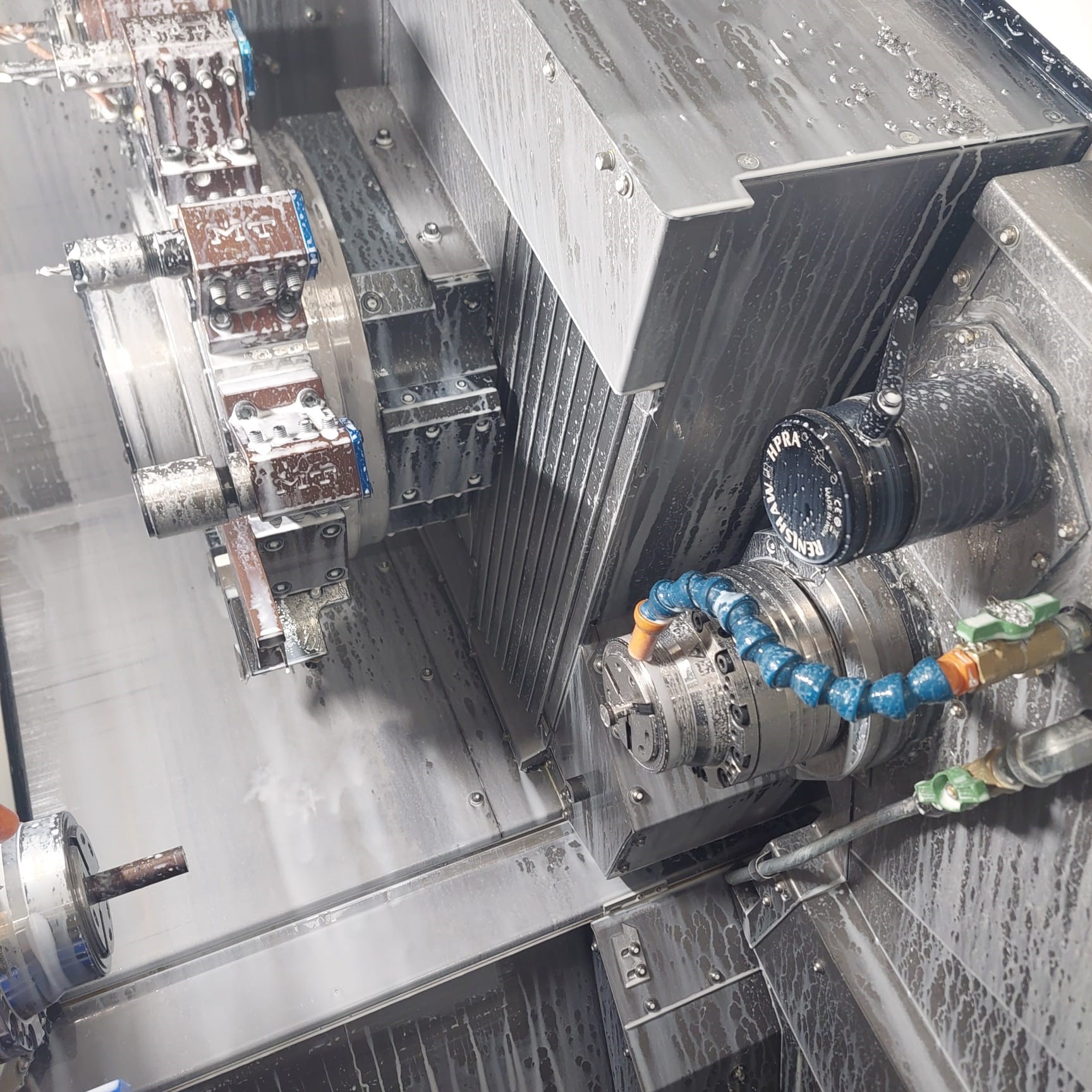

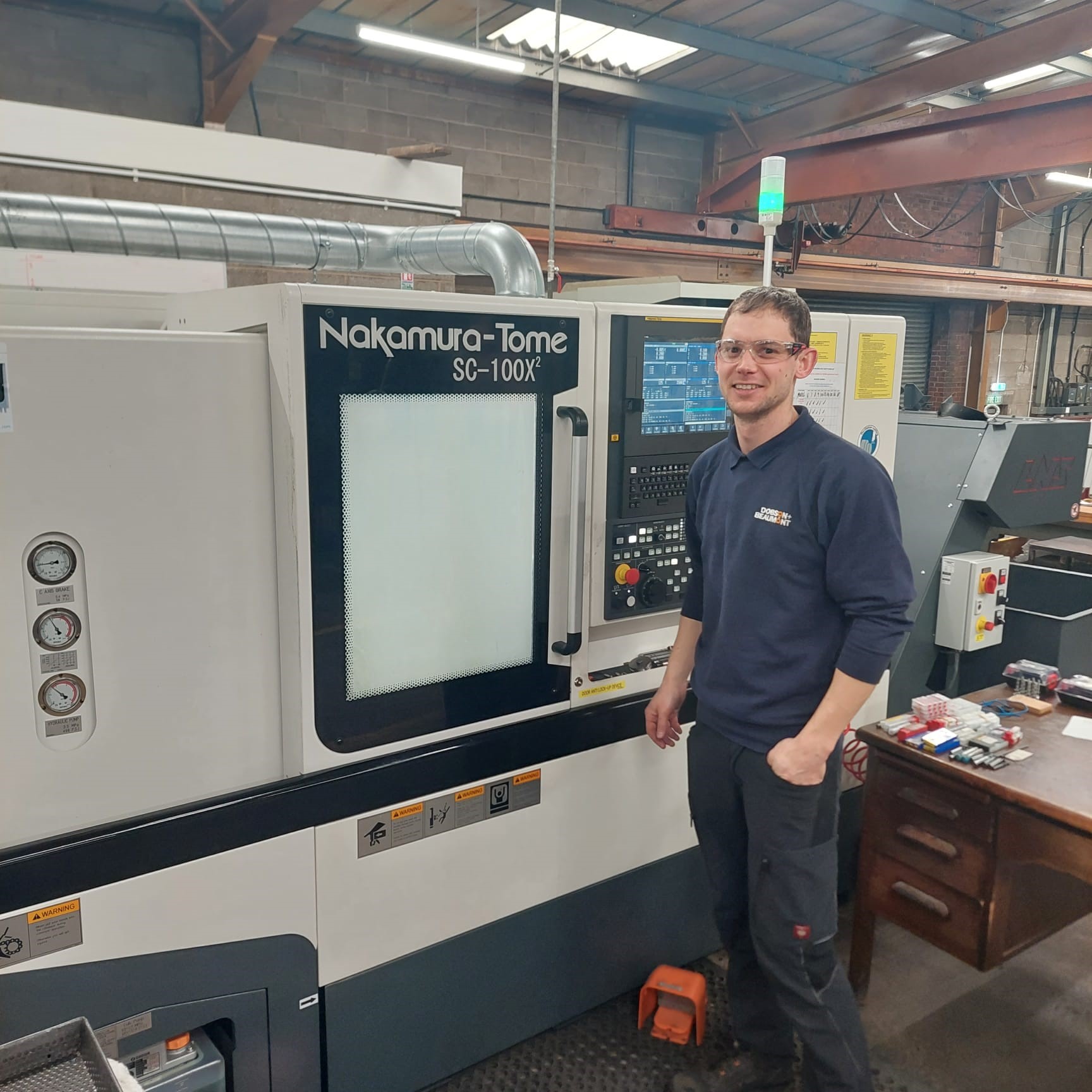

The Nakamura SC100X2 was the solution for the increased workload that fitted the bill perfectly. Installed and running at the end of 2022, the SC100X2 is already reducing cycle times by upward of 30%. This is credited to several factors. Firstly, the new SC100X2 offers superimposed machining. “The superimposed machining is a game-changer for our business, we can now hit parts with two tools simultaneously by overlapping operations between main and sub-spindles. This has reduced cycle times noticeably already. On high-value motorsport studs that we produce frequently, we have cut the cycle time from 3 minutes to 1minute 30 seconds.”

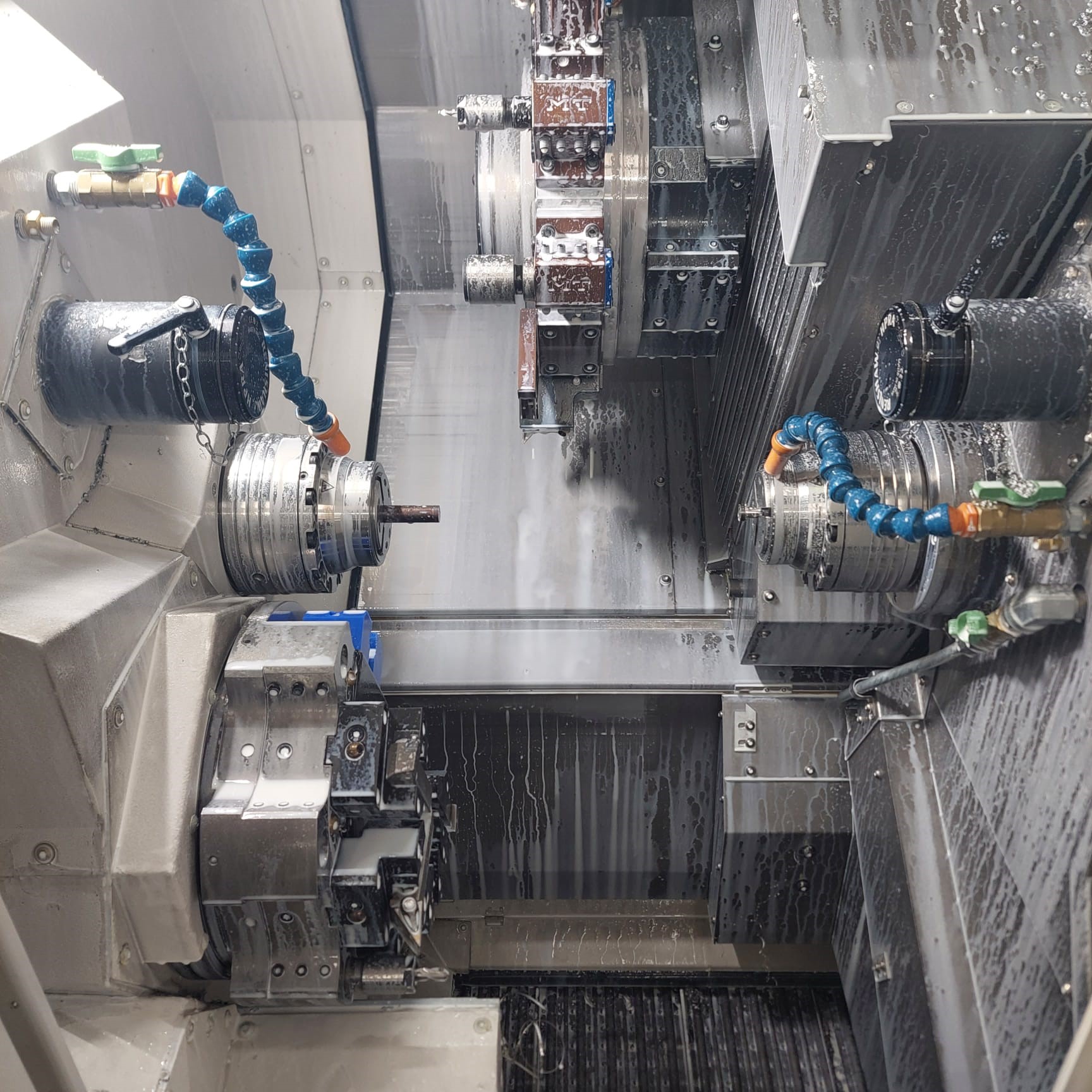

The sub-spindle can move not only toward the main spindle for component pick-up, but also in synchronicity with the lower turret for machining operations that can be conducted whilst the upper turret is machining on the main spindle. One of the key benefits of the machine is the 70bar coolant pressure. This evacuates swarf during heavy machining cycles and eliminates the need for pecking cycles when drilling. It also enables the company to machine more challenging materials whilst supporting the reduction of cycle times and extending tool life.
