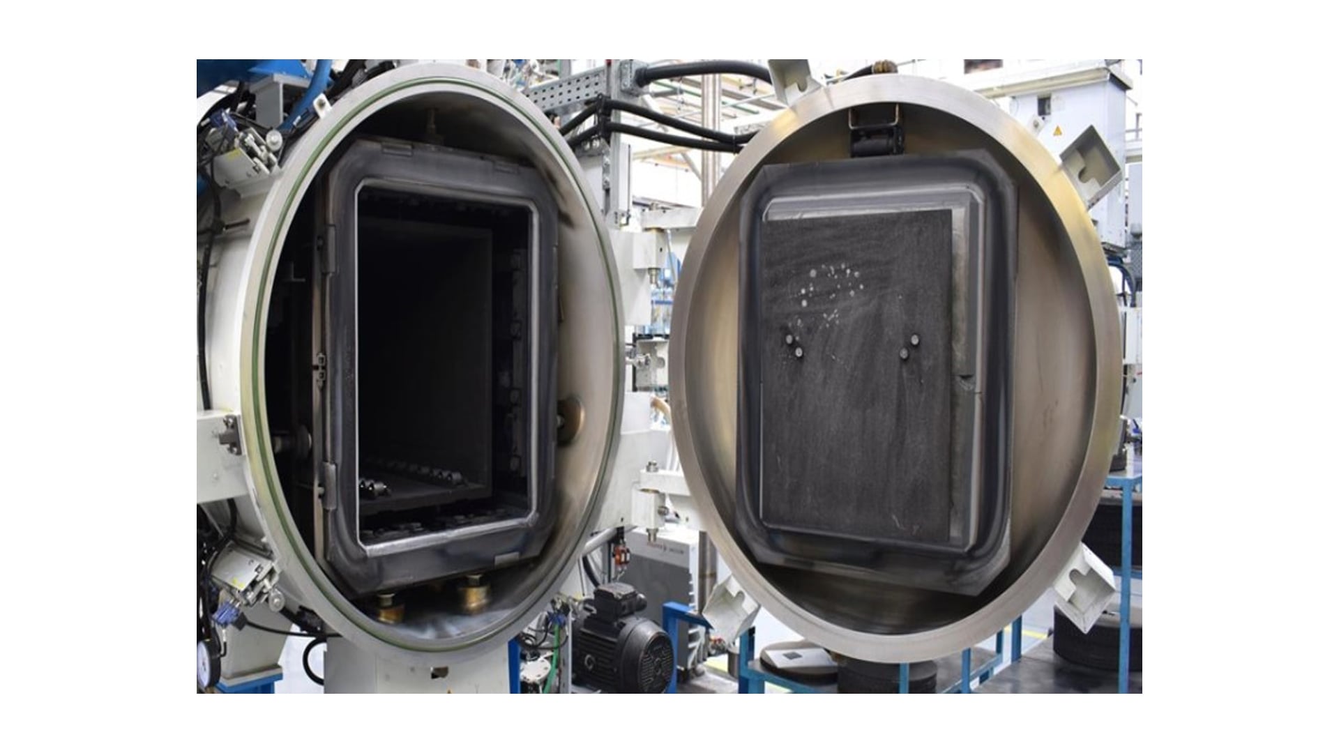

Sintering
One of the most intense steps in tool insert manufacturing is the sintering process. After the carefully selected metal powders are milled and then pressed into shape, the inserts are very fragile. It is at this stage that the inserts are fused, or sintered, into solid pieces.
Inserts can spend up to 13 hours in a sintering oven, at a temperature of approximately 1,500 degrees Celsius (°C), where they are sintered into an extremely tough cemented carbide product — almost as hard as diamond.
Sintering is not a quick process — but time is money. Keeping powerful furnaces in operation for many hours at a time uses up immense amounts of energy, but cutting corners and producing fragile inserts would be even more wasteful. If a reduction in energy consumption is to be made possible, it would require a reduction in cycle times without compromising product quality.
So, that’s exactly what Sandvik did. Teams at Dormer Pramet, a global cutting tool manufacturer and part of the Sandvik Group, have successfully reduced the cycle time of their sintering process by almost 100 minutes. To achieve this reduction, Dormer Pramet engineers worked in close collaboration with research and development specialists from Sandvik Materials Technology (SMT) in Pune, India to redesign the gas flow passing through the charge of the sintering furnaces.
Dormer Pramet’s facility in Sumperk, Czech Republic, is the first to trial the new sintering process. Shorter sintering cycles also means that the facility can produce more parts while using the name amount of energy.
