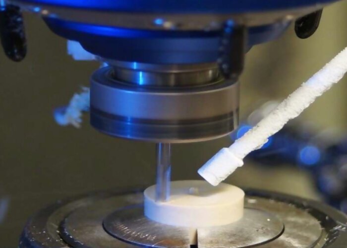

Cryogenic cooling has proven to be an essential breakthrough for various precision machining applications, and now, Industrial Cryotech’s CryoCut Vista system is pushing the boundaries of what’s possible in the machining of high-performance thermoplastics. The CryoCut Vista system is designed specifically for use in CNC machines and offers an innovative cryogenic technology solution that delivers precise cooling directly to the cutting zone. This enables clean, burr-free machining of polymers, which are frequently used in demanding industries such as aerospace and medical applications.
Originally, cryogenic technology was developed to enhance machining for metals such as hardened steel, iron, powdered metals, cobalt chrome, and even carbide thermal spray coatings. However, as precision machining of thermoplastic polymers has become more common, the demand for similar advancements in cooling technology has been growing. CryoCut Vista addresses this need with its ability to maintain the point-of-cut at temperatures as low as -50°F. This level of cooling significantly improves material stiffness and reduces thermal distortion during machining.
The controlled reduction in temperature leads to enhanced dimensional accuracy, achieving tolerances as tight as 0.000039″. Additionally, CryoCut Vista results in a remarkable 20% improvement in surface finish quality, which is a critical factor when machining materials used in high-precision applications.
The CryoCut Vista system features a smart digital interface that allows operators to easily control and maintain temperatures within a ±2°F range. Once activated via an M-code, the system deploys a stream of liquid nitrogen through stainless steel nozzles, creating an inert, residue-free cutting environment. This process not only ensures higher process stability but also meets the sterility and biocompatibility standards that are particularly vital in medical manufacturing.
CryoCut Vista offers a clean, dry machining environment, completely eliminating the need for traditional cutting fluids. The absence of coolant residue allows for cleaner machining processes, which is especially important when manufacturing components that require a high degree of cleanliness and accuracy.
One of the standout features of CryoCut Vista is its potential to drastically reduce operational coolant costs. In internal testing, the system demonstrated up to a 500% reduction in coolant expenses, thanks to its efficient use of nitrogen. Since nitrogen is abundant in Earth’s atmosphere (comprising 78%), the system offers a sustainable and cost-effective solution for precision machining operations.
This reduction in operational costs, coupled with the improved machining characteristics, makes CryoCut Vista a highly attractive option for industries that rely on high-precision plastic parts. The system not only delivers better results but also aligns with the growing trend of sustainability in manufacturing practices.
Precision machining of plastic materials is notoriously challenging, particularly when dealing with high-performance polymers. Heat generated during the cutting process can cause the material to enter the “rubbery” melt zone, leading to issues with part distortion, poor finish, and the formation of unwanted burrs. CryoCut Vista addresses this problem by cooling the material at the point of cut, thus preventing heat buildup and ensuring higher machining accuracy, reduced burr formation, and improved overall productivity.
