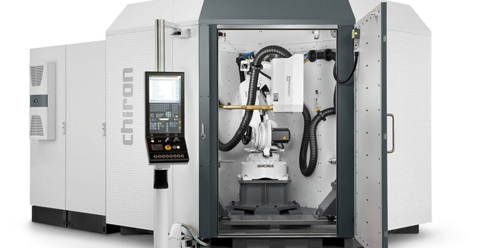

Chiron AM Cube is a compact 3D metal printer for manufacturing large and complex components. It is suitable for coating and repairing components up to 500 mm in size, for cylindrical components up to a meter long, and for the near-net-shape production of semi-finished products.
The printer can be provided with up to 3 deposition heads with patented, hardwired energy, material and data supply. Maximium workpiece dimensions are 3-axis up to 1,000 x 400 x 500 mm; 4-axis up to 300 x 1,000 mm; and 5-axis up to Ø 500 x 500 mm.
Automatic deposition-head changing permits wire or powder feedstock material for 3D printing or coating, internally or externally. Its modular design means the AM Cube can be provided as a 3-axis, 4-axis, or 5-axis system.
