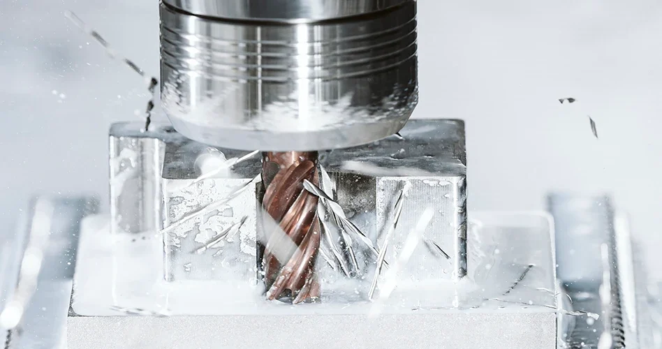

Ceratizit USA Inc. has unveiled a redesigned version of its MonsterMill ISO-S line of milling cutters, a development aimed at boosting efficiency, tool life, and surface finish quality in the machining of nickel- and titanium-based superalloys. The enhancements include the introduction of a new 6-flute cutter, complementing the existing 4- and 5-flute options. This addition is specifically engineered to deliver superior surface finishes, significantly reducing the need for costly and time-consuming secondary operations.
Machining superalloys such as Inconel, Hastelloy, and Waspaloy has long posed challenges for manufacturers due to their extreme hardness and high tensile strength. These properties lead to rapid tool wear, elevated heat generation, and higher overall machining costs compared to more conventional metals. The redesigned MonsterMill ISO-S series addresses these challenges head-on with a carefully engineered balance of premium solid carbide substrates, optimized geometries, and robust coatings that collectively enable smoother and more reliable cutting action across demanding applications.
“Machining nickel-based alloys comes with its own set of challenges,” explained Eric Gerringer, Technical Director at Ceratizit USA. “One of the most significant issues is the material’s low thermal conductivity, which causes heat to remain concentrated in the cutting tool rather than dissipating into the chips. To address this, we re-engineered the geometry to minimize heat generation during machining. In addition, polished chip flutes and an optimized coating reduce friction, improve chip evacuation, and keep operations efficient.”
Central to the performance of the MonsterMill ISO-S line is Ceratizit’s proprietary DPX22S Dragonskin coating, which has been specifically developed for machining nickel-based alloys. Applied in layers of 4–6 micrometers, this coating delivers exceptional thermal stability and wear resistance. Its unique layer structure ensures extended tool life, even under extreme cutting conditions, while maintaining dimensional accuracy and surface quality across long production runs.
The cutters also feature a variable helix design and irregularly pitched cutting edges that suppress vibrations. By minimizing chatter, these tools not only increase stability and performance but also extend operational life, reducing the risk of breakage. Another advantage of the new geometries is their suitability for regrinding, which further extends tool usage and lowers overall costs for manufacturers.
The MonsterMill ISO-S line is particularly well-suited to the aerospace sector, where precision, consistency, and durability are paramount. The 4-flute cutter is offered in two different lengths with a diameter range from 3 mm to 20 mm, and it is available in both HA and HB shank types with corner radii ranging from 0.2 mm to 0.5 mm. The 5-flute version covers diameters from 6 mm to 16 mm, also with HA and HB shank types and multiple corner radii options. The newly introduced 6-flute cutter, meanwhile, is available with diameters between 6 mm and 16 mm, HA shank type, and corner radii ranging from 0.2 mm to 2 mm, ensuring versatile options for high-performance applications.
