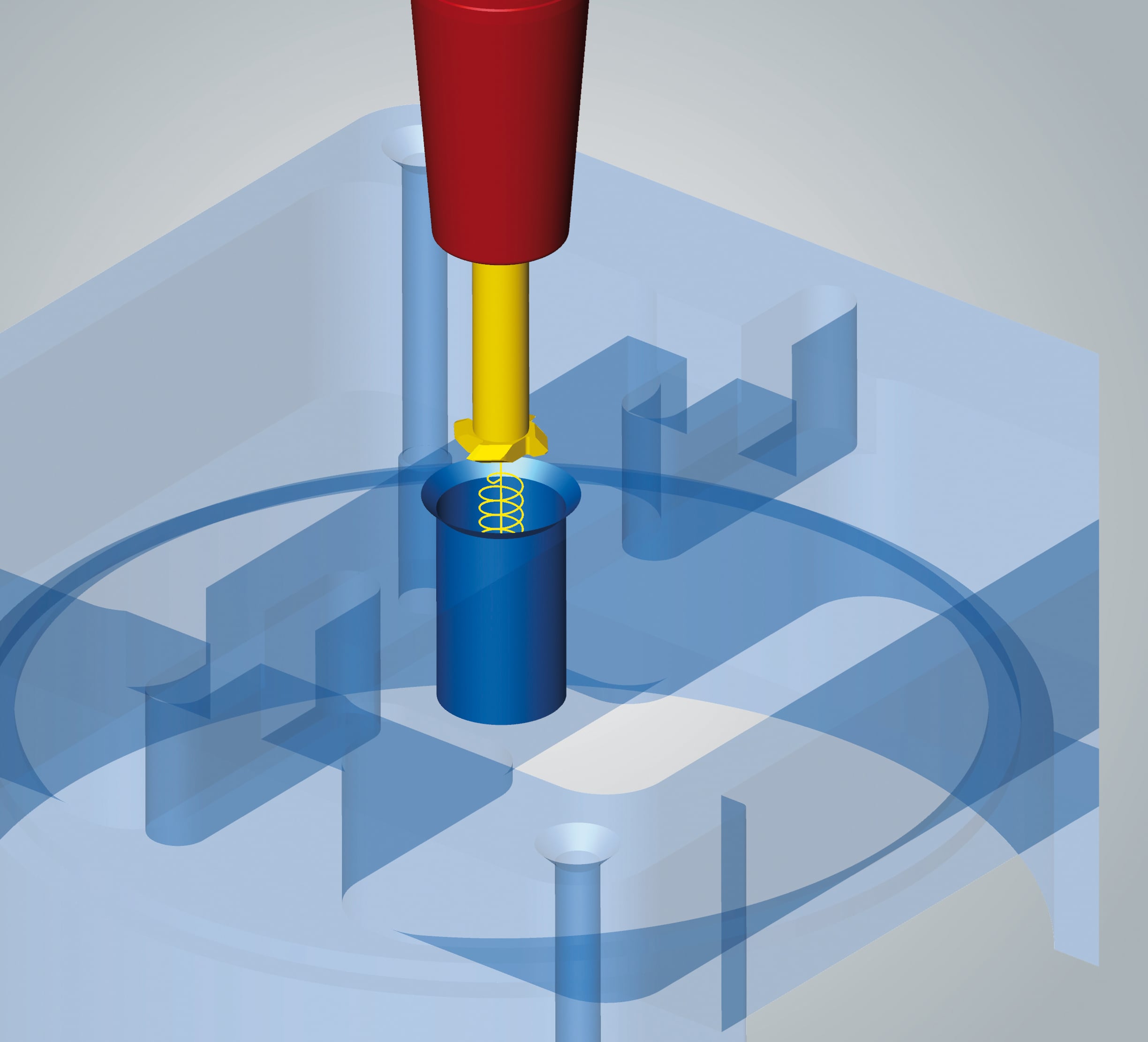

Thread milling options have been completely redesigned for hyperMILL® 2019.1 to improve convenience and user friendliness for the programmer. The module supports a variety of different thread milling cutter types and allows extremely easy selection of right-hand and left-hand threads or the definition of the milling direction from bottom to top or vice versa. The thread milling feature also offers automatic approach and retract macros, a selection of roughing options and simplified programming.
