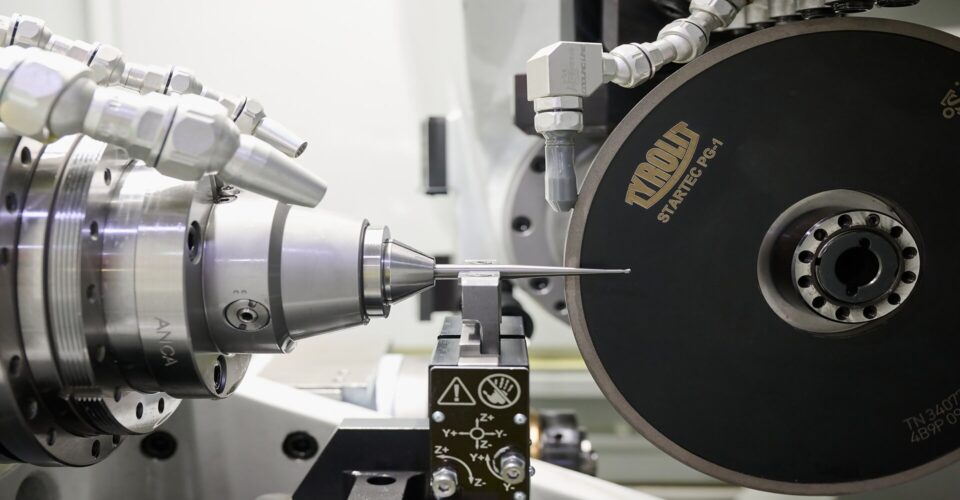

ANCA’s MX7 grinding platform offers an innovative solution for seamless tool grinding in a single setup. The platform eliminates the need for multiple wheel changes, streamlining operations and enhancing efficiency. Equipped with advanced features, it supports comprehensive tool grinding while ensuring high precision and reduced cycle times.
The MX7 platform supports a wide range of tool shapes, including taper ballnose, corner radius, lollipop cutters, step tools, and more. It accommodates tool diameters ranging from 1 mm to 25.4 mm, allowing manufacturers to complete multiple tasks in a single setup. The P-axis Arobotech support stabilizes blanks at the grind point, delivering surface finishes below 0.2 Ra while significantly reducing setup times.
The platform comes with six wheel packs, enabling uninterrupted grinding at various positions depending on the tool’s geometry. Its hydraulic pump automatically adjusts clamping pressure based on diameter, optimizing cycle times and ensuring consistent results. The inclusion of Arobotech pads accommodates a range of diameters (3-25 mm) without requiring additional adjustments, further enhancing the platform’s efficiency.
