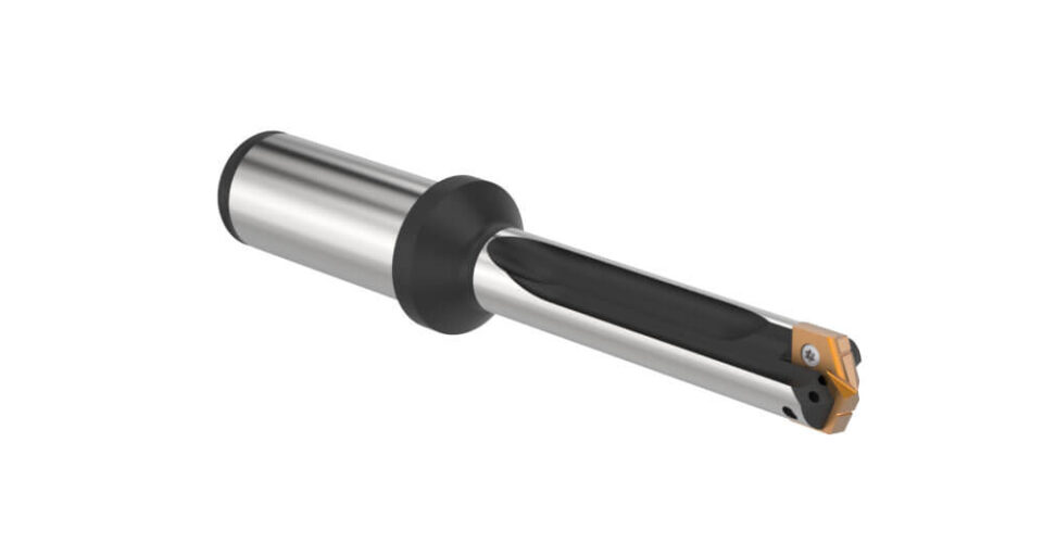

Allied Machine and Engineering has expanded its T-A Pro product line with the introduction of new drill and chamfer holders, designed to help manufacturers drill and chamfer holes in a single operation. This innovation eliminates the need for secondary operations like chamfering or deburring — as well as tool changes — significantly reducing cycle times and improving production efficiency.
The new holders are ideal for automotive, heavy equipment, and mold & die industries, where large volumes of threaded holes are common and productivity gains can have a major impact on throughput. Compatible with all existing T-A Pro inserts, the drill and chamfer holders are available in Y-3 series and sub-series A and C, offering broad application flexibility.
Each holder provides a 0.040″ (1.0 mm) × 45° chamfer for multiple thread specifications, including UN, ISO, NPT, NPS, BSPP, BSPT, and BSW, while also edge-breaking the top of the hole to minimize secondary deburring. With flute lengths starting at 2×D, the holders can be used for extended-length drilling up to 15×D, making them well-suited for deep-hole applications.
What sets the T-A Pro drill and chamfer body apart is its wide diameter range, allowing users to perform both drilling and chamfering with a single tool — without compromising performance. A user-friendly selection guide helps operators quickly identify the correct body and insert combination for specific thread sizes, and Allied Machine also offers customized solutions for unique diameter and depth requirements.
