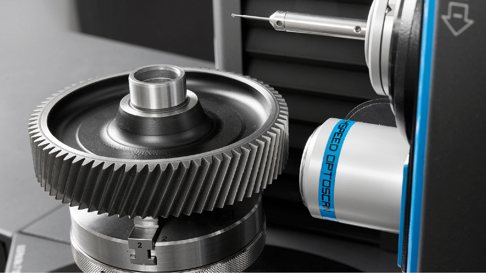

Metrios measuring machines replace several traditional measuring steps and instruments such as profile projectors, micrometers and plug gauges, among others.

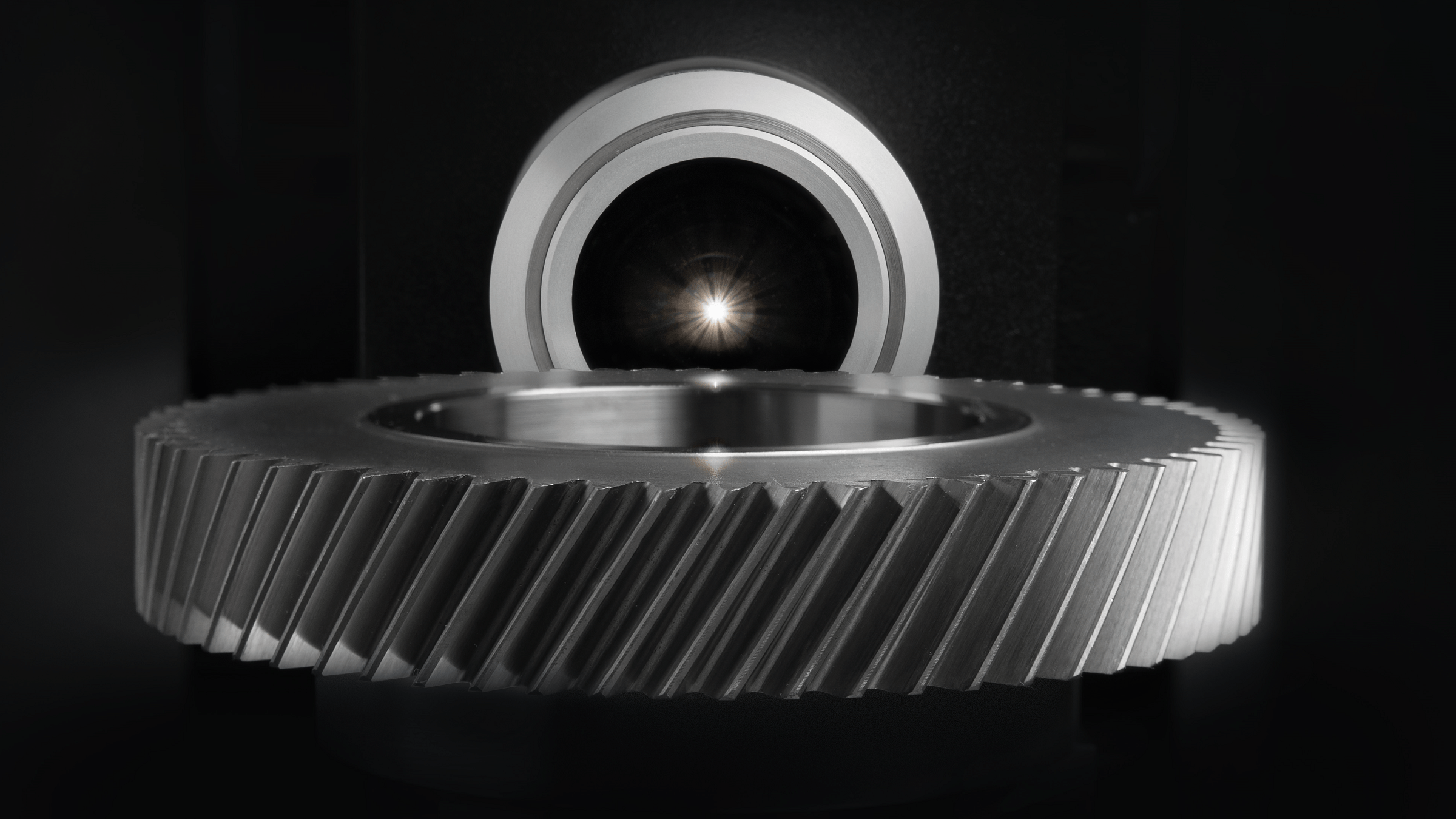

Gears are measured with specialized gear measuring machines that probe the surface of the tooth. However, as the number of measuring points increases, so does the total measuring time for a part, which is why the common practice is to measure just a few teeth or a few traces on a tooth’s surface.
A digital measuring instrument like Metrios supports the gear measuring machine by reducing its workload.
Measure multiple gears on the shop floor in a single measurement cycle.
Optical metrology systems operate without contact and provide high resolution, thus obtaining dimensional measurements and profile comparisons in a few seconds.
Moreover, these measuring machines allow control of one or more phases of the production process through fast, precise, and objective measuring tests outside the metrology room, at a controlled temperature, allowing the operator to intervene in real time on the manufacturing machineries.
The casual and free positioning of the parts on the stage allow measurements of multiple elements during the same measurement cycle and does not require the presence of specialized personnel.
With an optical measuring machine, the operator can detect almost all dimensions including the number of teeth, internal and external diameters, roll dimension, circular thickness and the Wildhaber dimension.
