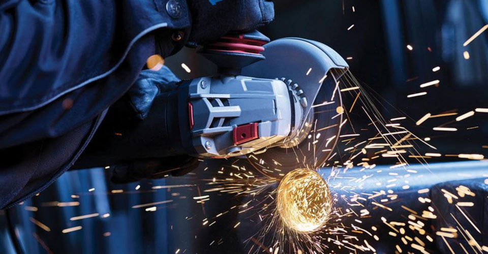

It is extremely important that trained operators use the appropriate tool and abrasive for the job. Whether it’s grinding, cutting, or finishing, there is always a proper way of doing things. One of the most common mistakes is using a cutting disc for some minor grinding or deburring application. This is a definite safety concern as cutting wheels are not manufactured to perform this job. Bonded cutting wheels are made to be used on a 90-degree cutting angle and are not reinforced to be side-loaded like a grinding wheel would be. The added stresses of using a cutoff wheel to grind can damage the wheel and result in a serious injury to the operator.

While there are safety factors inherent in ANSI and OSHA regulations, they may not account for an abrasive being used on an incorrect tool. For instance, a common question is whether a worn-down 7-in. grinding wheel can be used on a 5-in. grinder. While it may fit, the 7-in. wheel was manufactured to a maximum rating of 8,600 RPM; a typical 5-in. grinder runs at approximately 10,000 RPM. Exceeding the recommended speed for an abrasive is not worth the risk. Use 5-in. wheels with 5-in. grinders; use 7-in. wheels with 7-in. grinders.

A very common shortcut is to remove guards when cutting or grinding because they are viewed as cumbersome or restrict some manipulation of the tool. This is a very dangerous practice that leads to serious workplace injuries. Consider the guard as one of the main lines of defence between you and the tool. If a wheel is damaged or faulty, it can become a dangerous projectile quickly, and without warning. Always use the guards; they are designed for your protection. If you think it’s necessary to take a guard off to finish the job, consider using another tool that can get the job done safely.
