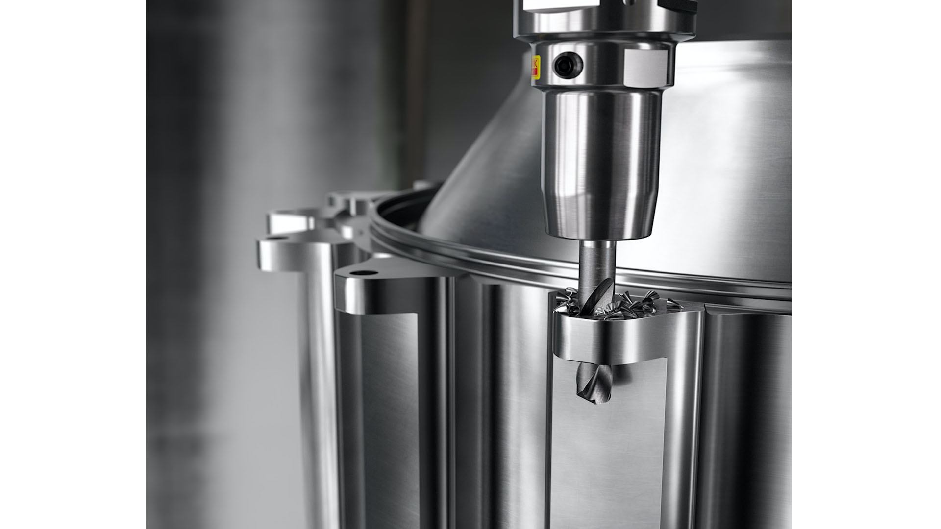

The investigation into causes, and possible preventions, of the white layer involved four tests of drilling the high-strength, nickel chromium material Inconel 718, a popular aerospace material. It was the first time any such investigation had been carried out by the customer.
The tests assessed drilling with two solid carbide drills by Sandvik Coromant, the CoroDrill R840 and CoroDrill R846. Each was run at two different sets of cutting parameters: 58 mm/min and 98 mm/min, respectively, and spin speed, 829 rev/min and 757 rev/min, respectively. Cutting force and torque data were measured throughout the tests, as was the white layer thickness.
Since these tests, R840 has been superseded by the CoroDrill® 860 with -GM geometry and R846 has been superseded by the CoroDrill® 860 with -SM geometry. Each of these next generation tools is designed to further enhance the tool life, without compromising hole quality.
The results gave some valuable insights into what causes white layer thickness. Particularly of note was that the R846 generated less white layer, due to the preparation of its curved and radial-cutting edges. Meanwhile, the straight cutting edges and chamfer imposed on the cutting edge of the R840 are believed to be linked with the increase in cutting force, torque and white layer thickness. So, the drill’s design determines whether high hole quality, with a reduced white layer, can be achieved without sacrificing cutting data.
Not only did the global aerospace manufacturer’s tests with Sandvik Coromant reveal a thing or two about the white layer, the company has also been able to eliminate some secondary processes, like reaming and plunge milling, which has resulted in time and cost benefits. What’s more, the results have also validated the design of Sandvik Coromant’s CoroDrill® 860 range of carbide drills.

The range includes the aforementioned CoroDrill 860 with -GM (CD860-GM) geometry, designed to be a good all-rounder for drilling challenging ISO P, M, K and H materials across all industry sectors. Also, the CoroDrill 860 with -SM geometry (CD860-SM), for machining ISO-S grades like super alloys (HRSAs), titanium and Inconel. The latter drill has proven especially popular in aerospace.With the CD860-GM and CD860-SM, Sandvik Coromant’s engineers applied the ethos that longer tool life and better hole quality is down to the design of the drill. The CD860-GM has an innovative polished flute design that improves the evacuation of chips, and yields high core strength and reduced cutting forces while drilling.
The CD860-SM, meanwhile, has a new grade and optimised and refined point geometry, which further enhances tool life when working with difficult-to-machine HRSA materials. The result is greater hole quality.
The CoroDrill 860 has already been proven in pre-market tests in a range of sectors. A mechanical engineering company in France put the CD860-GM to work on AISI 4140 structural steel. It was able to achieve quality holemaking with both a concave and convex entry of the drill, with good straightness and tolerance. The company has since formed a new business relationship with Sandvik Coromant.
Another Sandvik Coromant customer, an Italian general engineering manufacturer, achieved a more than 45% productivity increase using the CD860-GM when machining the strong, steel alloy 34CrNiMo6, versus use of a competitor’s drill. It also achieved a 100% greater tool life. Elsewhere, the CD860-SM has yielded impressive results in the machining of Inconel 718. In particular, testing undertaken in Katowice, Poland, was able to achieve a 180% improved tool life with the CD860-SM versus the use of the CoroDrill R840.
