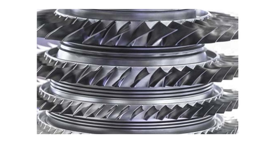

In a precision mechanical assembly comprising compressor, combustor and turbine, bladed disks play an important role in minimising drag and optimising airflow in the engine and the amount of thrust it produces.
Introduced in the mid-1980s, a bladed disk is a single component comprising a rotor disk and multiple curved blades. By removing the need to attach separate blades to a bare rotor, bladed disks have helped transform turbine design, substantially reducing component counts, increasing reliability and maximising engine efficiency.
Bladed disks are machined from very hard high-value metal, typically titanium or nickel-based alloys. Milling is by far the most important machining process during their manufacture, and due to the bladed disk’s high curvature surfaces, multi-axis CNC machine tools and advanced software are required.
Bladed disk milling usually involves rough slot-milling and semi-finishing to create a near net component, followed by fine milling to arrive at the finished high-precision blade and rotor surfaces.
