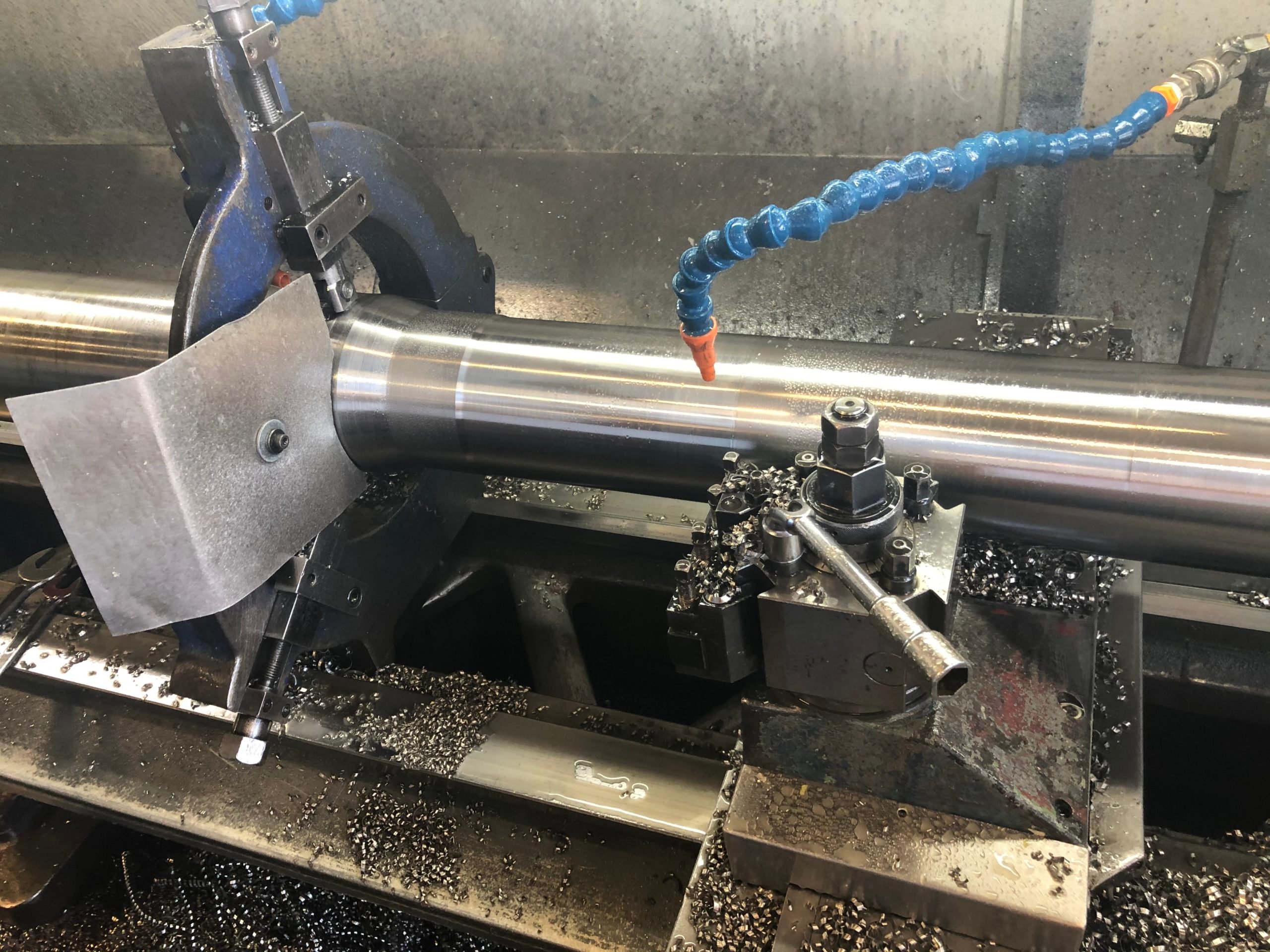

Despite the stable machine platform, the new coolant and the slide guarding, the trio of engineers realised that the steady rest on the DSG machine needed to be moved from an average distance of 1m from the cutting tool to 350mm to increase the rigidity and stability for ceramic tooling. This is because ceramic tooling is inherently more brittle and susceptible to vibration than its carbide counterparts.

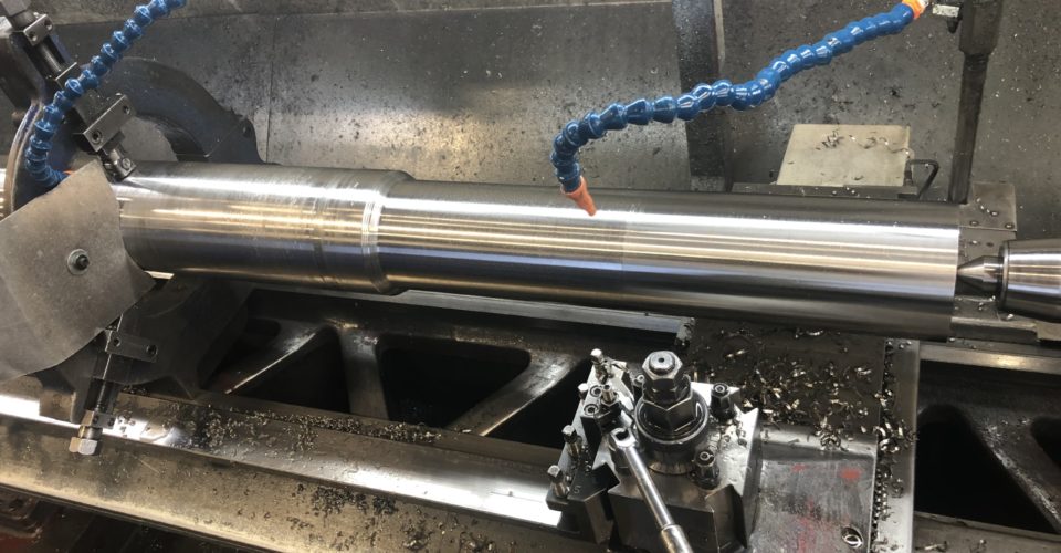

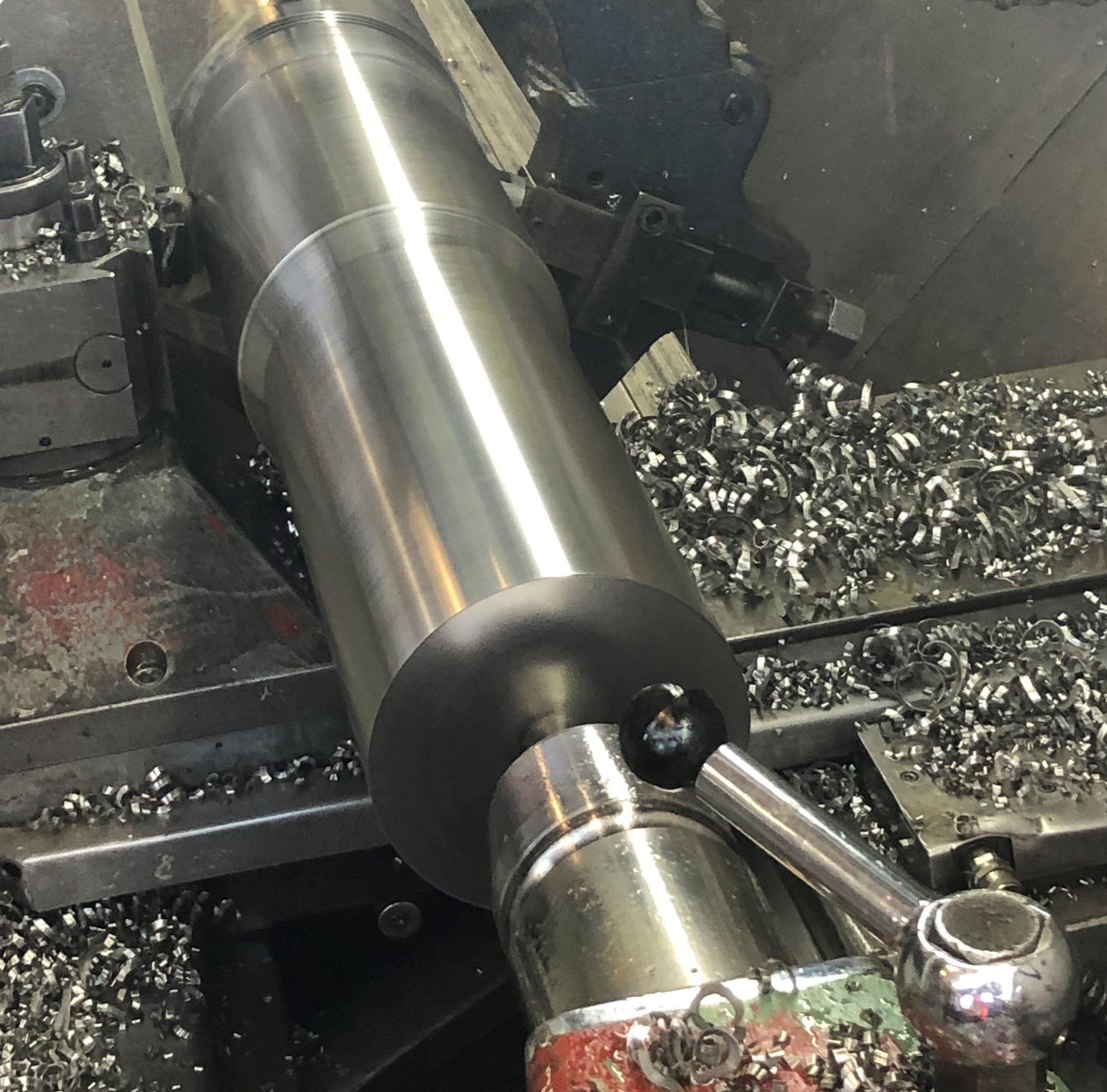

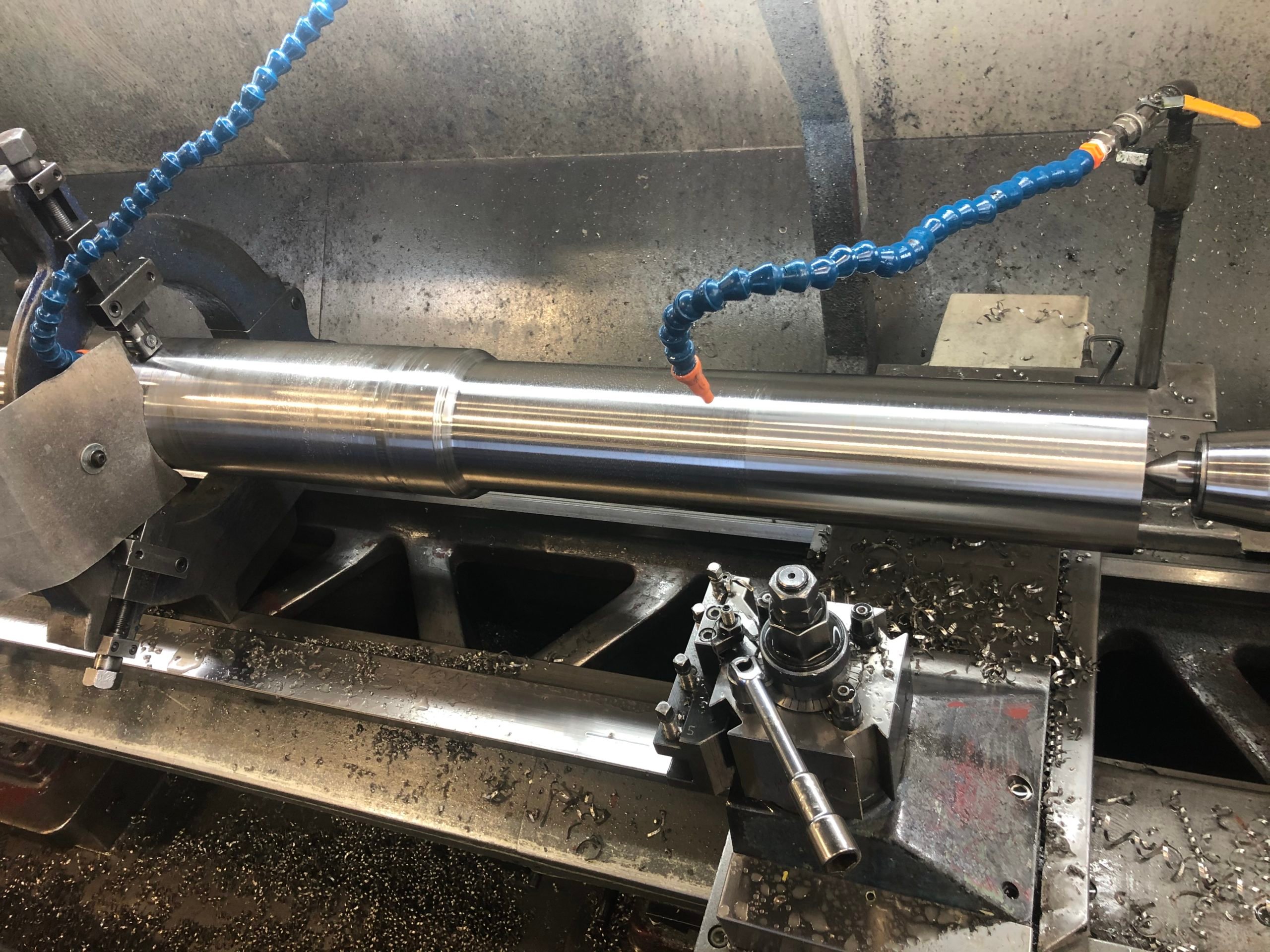

Once the MSC, Sulzer and NTK engineers had done the groundwork, the trials began. As MSC’s Stuart confirms: “Upon the recommendation of NTK’s Glyn Shaw, we selected the NTK’s Bidemic range of inserts and in particular the JX1 grade with a round RNMG12 insert geometry. This was because the new patented Bidemic range offers better wear and notching resistance compared to whisker ceramic grades that are widely used in the industry.”
“The NTK trials started at a cutting speed of 250m/min, but we found the optimal speed for this job at 370m/min, a massive increase from 40 to 50m/min with carbide. We also increased the spindle speed from 80 to 200rpm to over 740 to 1000rpm depending upon the diameter being turned. Cutting with an average depth of 1.5 to 2mm, we reduced the rough machining time on the five inconel 625 shafts from 14 hours to 2 hours and 4 minutes per shaft. This yielded a Material Removal Rate (MMR) of 222cm³/min up from the previous rate of 30cm³/min. An unexpected benefit was the improved concentricity after releasing the steady rest. With carbide tools, the rollers were showing a run-out of up to +/-1mm, yet with the ceramic inserts that only increased workpiece temperature by 9C degrees during machining, the runout was consistently between +/-0.15 to 0.20mm – not only alleviating Sulzer’s initial concerns overheat but showing a performance and concentricity improvement.”
