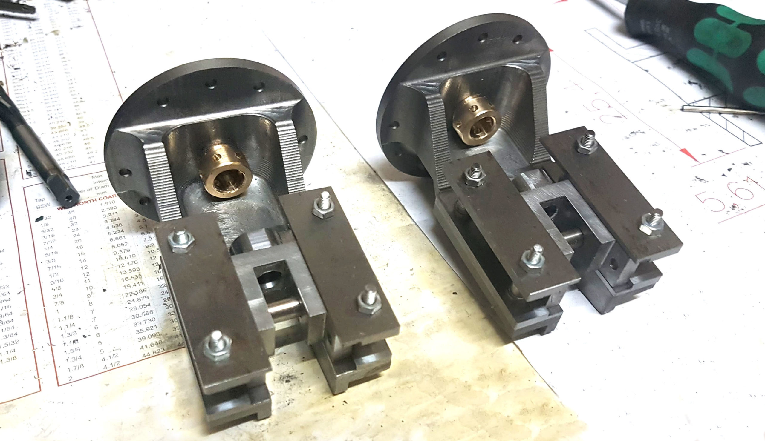

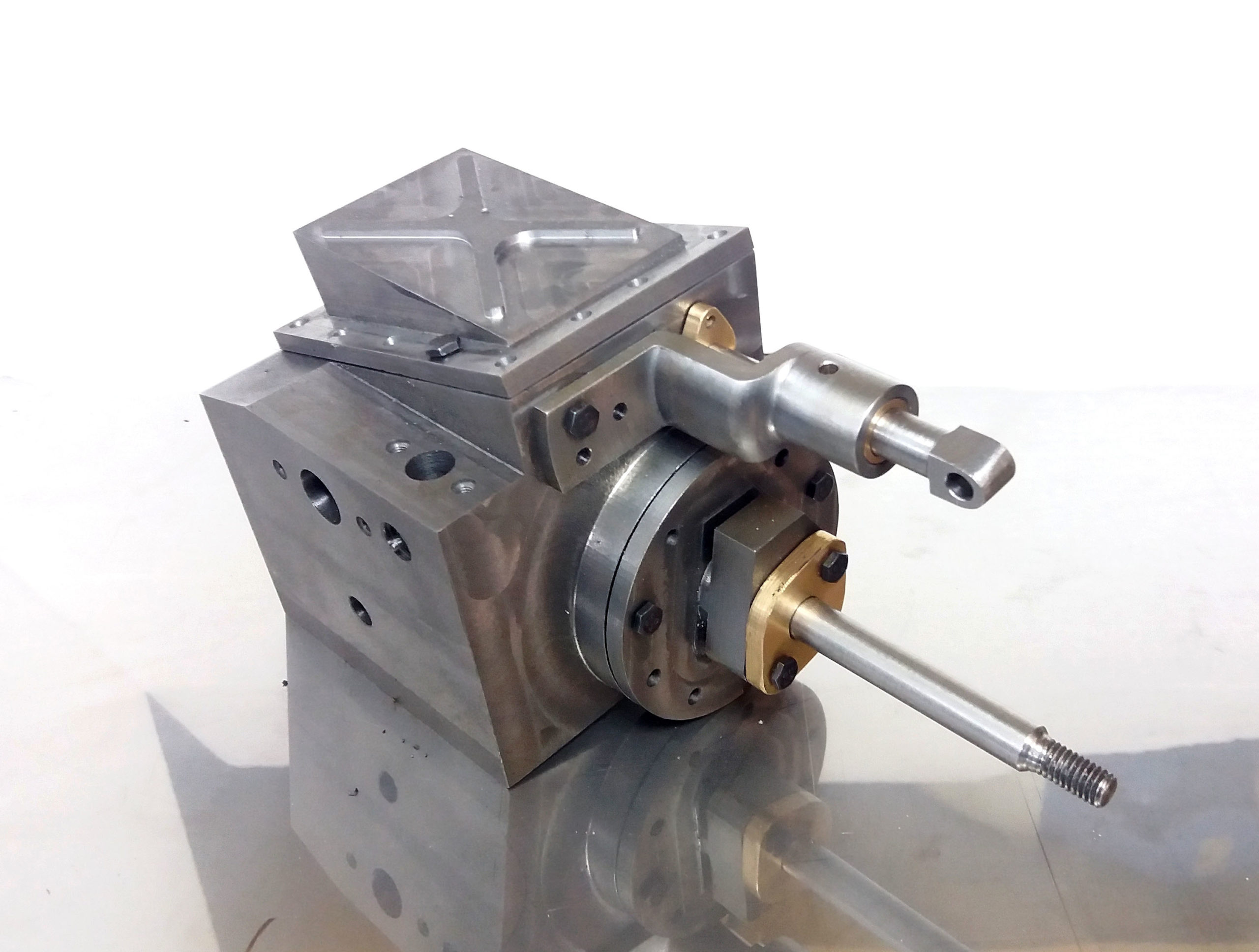

The machine – a compact, high-performance DNM 4500 – was installed at 17D’s (2,500sq. ft.) facility in July 2020, and is being used to machine a range of precision components, that include live steam locomotive parts (valve gears, cylinders etc.), chassis, axles, bogies, couplings, buffers, wheels etc., made from a diverse range of materials that include aluminium, cast iron, carbon steel etc.

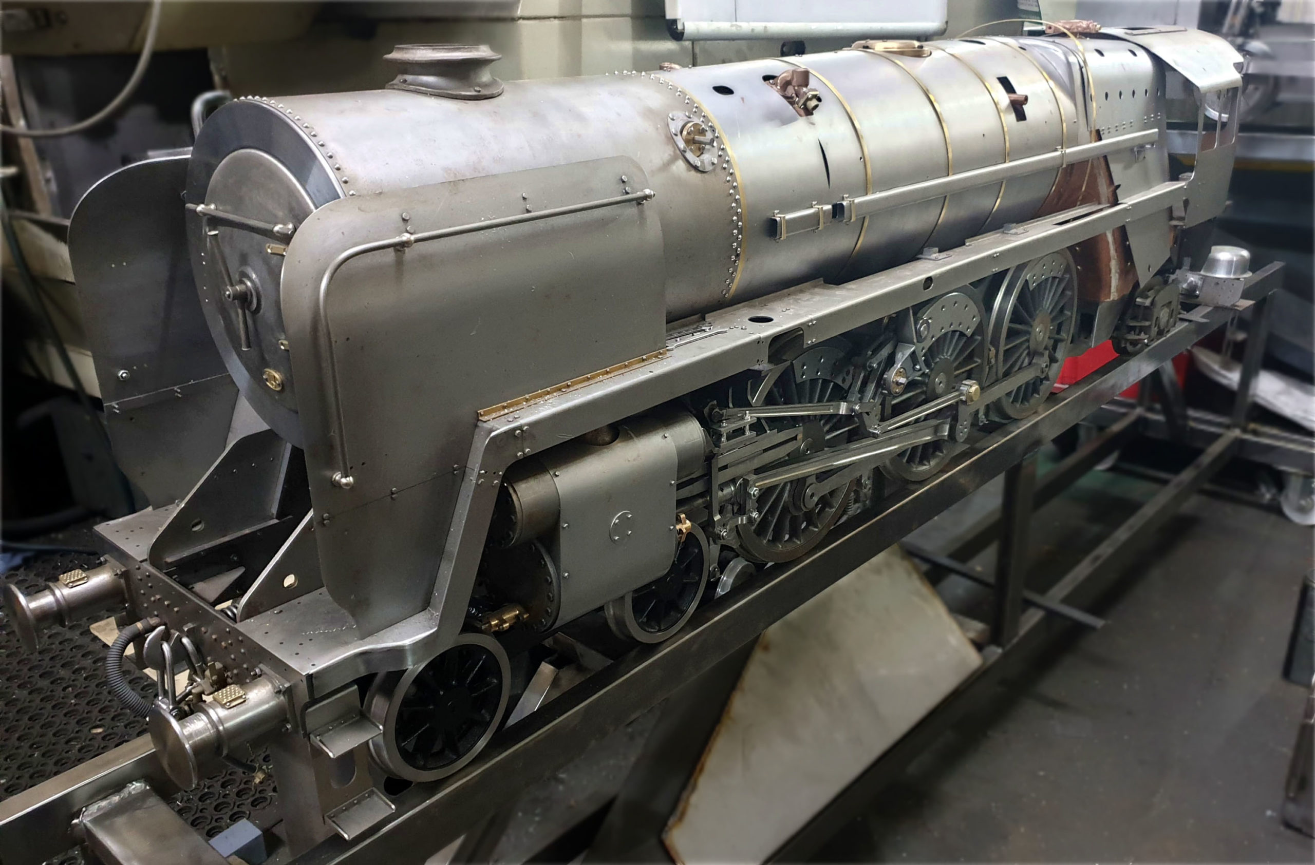

17D, established in 2010, manufactures a range of scaled working models of locomotives, carriages and wagons for three miniature railway gauge systems: 5”, 7.1/4” and 10.1/4”.  (The company’s locomotives for the 5” gauge are a scale of one-twelfth, at around six feet long, rising to approximately 12 feet for the 10.1/4” gauge).
In addition to designing and manufacturing miniature locomotives and associated rolling stock, the company is focused, and devotes significant time and resources, on producing and supplying high-quality, cost-competitive and quick turnaround parts and spares for a myriad of UK and internationally-based customers that include hobbyists and private collectors through to clubs and commercial organisations.

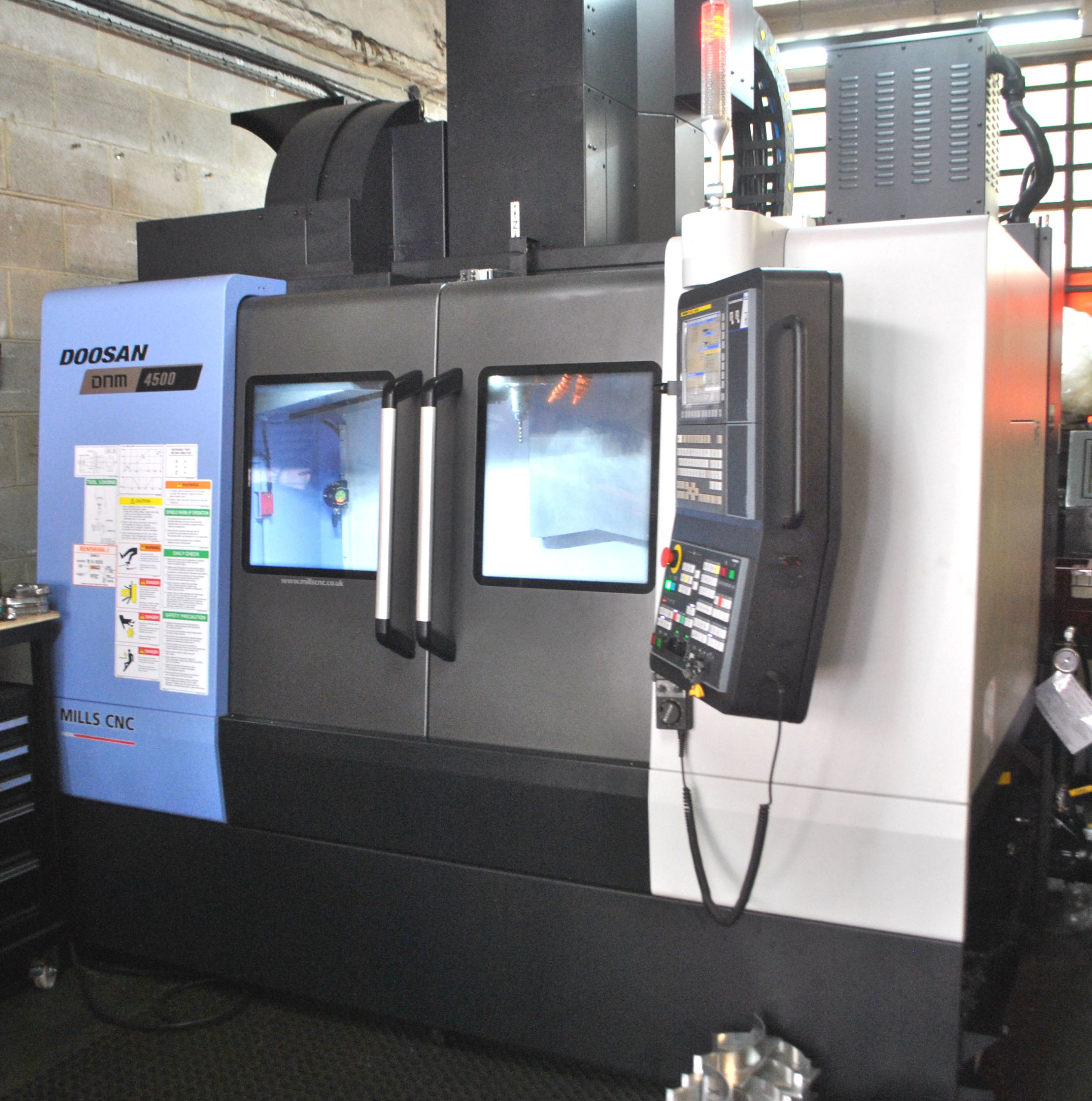

 The DNM 4500 is a high-speed, highly-rigid and versatile 3-axis vertical machining centre ideal for a range of applications. Standard features (and major selling points) include a large working envelope (800mm x 450mm x 510mm), a direct-coupled spindle (18.5kW/8,000rpm), roller LM guideways and an on-board thermal error compensation system.
The machine boasts fast rapid rates (36/26/30m/min), a large work table (1000mm x 450mm with 600kg maximum table load), and a 30-position ATC.
The machine supplied to 17D was equipped with the Fanuc i control but can also be specified with either a Siemens 828D or Heidenhain TNC 620 control.
