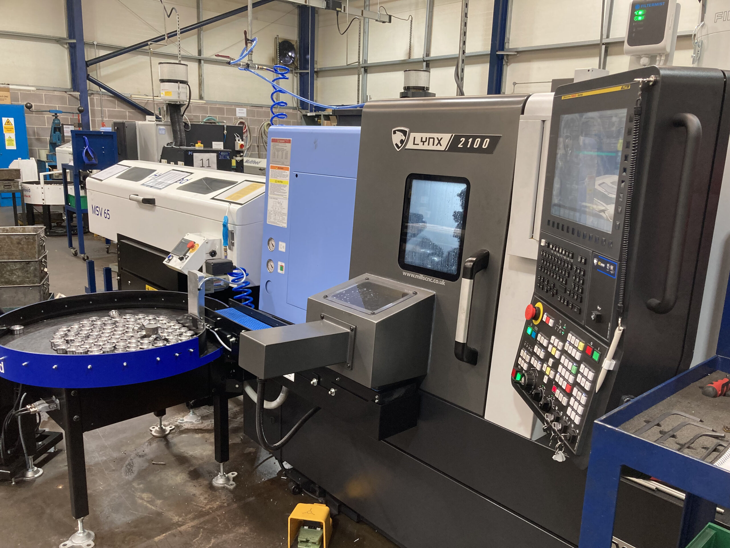

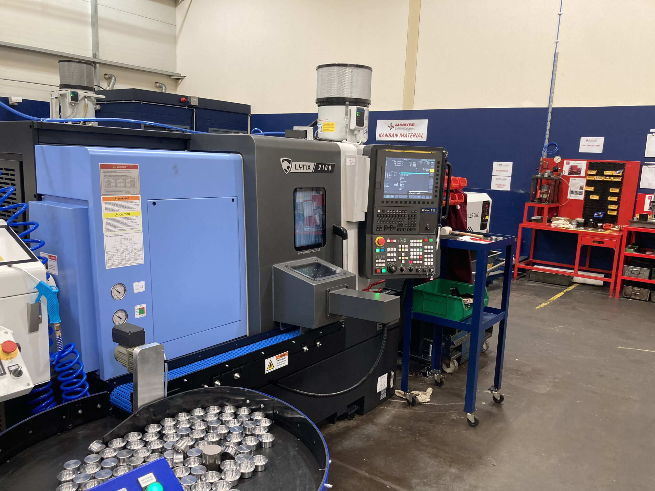

The machine, a Fanuc-controlled 8” chuck/65mm bar diameter Lynx 2100B lathe, was installed at Alwayse Engineering’s large, impressive and integrated manufacturing facility in Birmingham in March 2025.
As part of the investment package, the machine was supplied with a HydraFeed MSV65 servo-driven, short magazine bar feeder, to facilitate continuous, unattended production, and a HydraFeed ROTA-RACK parts accumulator and handling system with an integrated belt conveyor, for improved machined part storage and protection.

The new Lynx 2100B installed in the company’s well-resourced machine shop has been positioned adjacent to five older DN Solutions’ and Doosan compact Lynx lathes acquired by Alwayse Engineering over the last 19 years. These machines comprise 2 x Lynx 220LC, 1 x Lynx 220C, 1 x Lynx 2100LMSB and 1 x Lynx 2100A.

DN Solutions’ Lynx 2100B is a popular, best-selling compact lathe equipped with a 15kW/4500rpm spindle and a 12-station, servo-driven turret with fast tool change capabilities.
The machine boasts 30m/min rapids on its X-axis and 36m/min rapids on its Z-axis, and features a 350mm maximum turning diameter and a 330mm maximum turning length.
In addition to the HydraFeed bar feeder and ROTA-RACK parts accumulator, the machine supplied to Alwayse Engineering was also equipped with the Doosan Fanuc iPlus control with 15” touchscreen iHMI, a FilterMist extraction unit and a customised pneumatic arm integrated to the machine’s parts catcher that helps remove swarf and coolant from each machined part.
