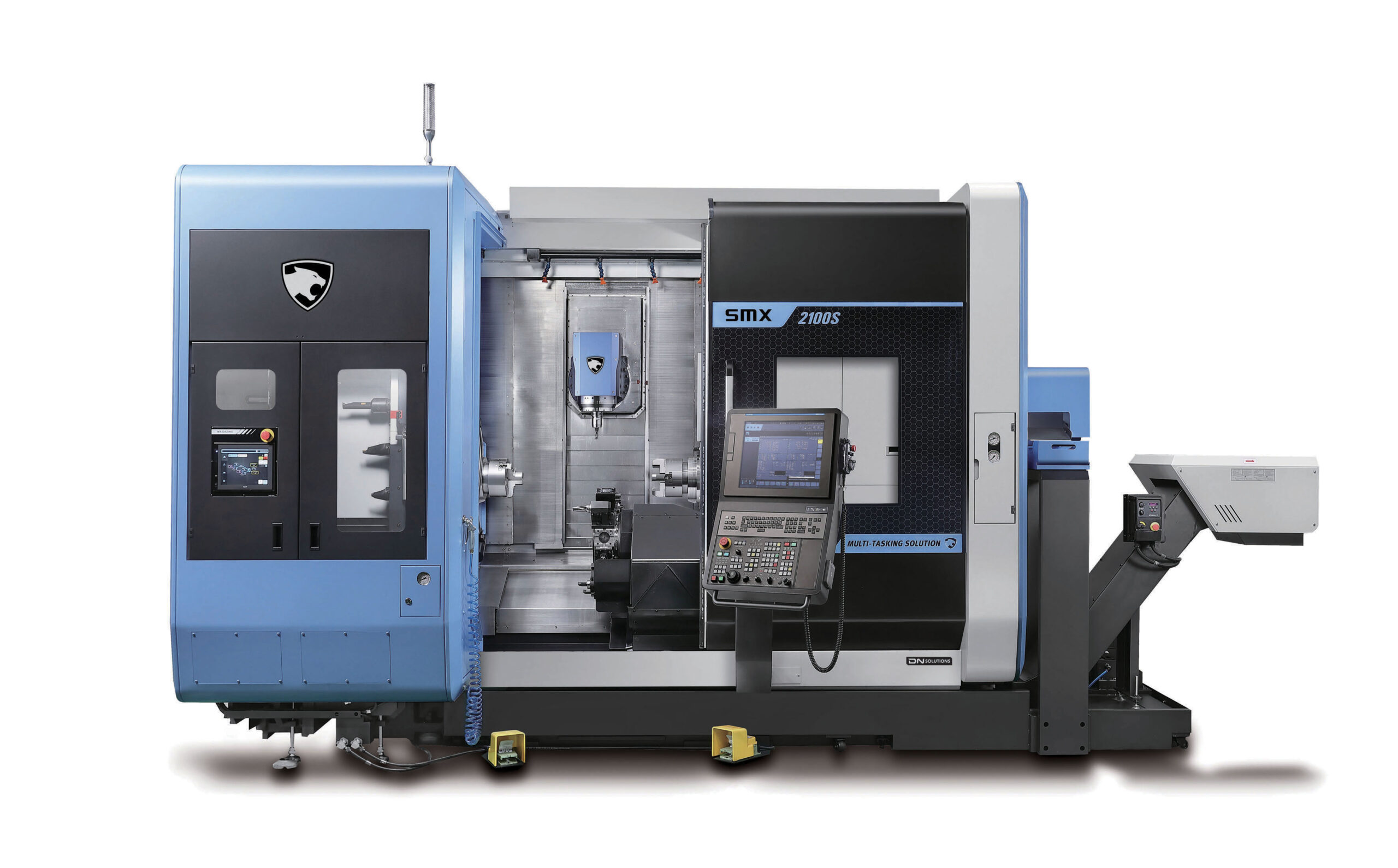

The Fanuc-controlled machine, equipped with two, left and right, opposing 22kW/5,000rpm spindles, a 12,000rpm B-axis milling head, a 40-tool position ATC, a 12/24 position turret with driven tooling capabilities (5,000rpm) and integrated thermal compensation, is an advanced, high-performance and proven multi-tasking machine designed for complex, high-precision ‘one-hit’ part processing.
The SMX 2100SB was selected by Mills CNC to appear at Seco’s Inspiration through Innovation event to demonstrate the machine’s inherent flexibility and the significant productivity and process efficiency gains it provides to component manufacturers machining complex, high-precision medical parts.

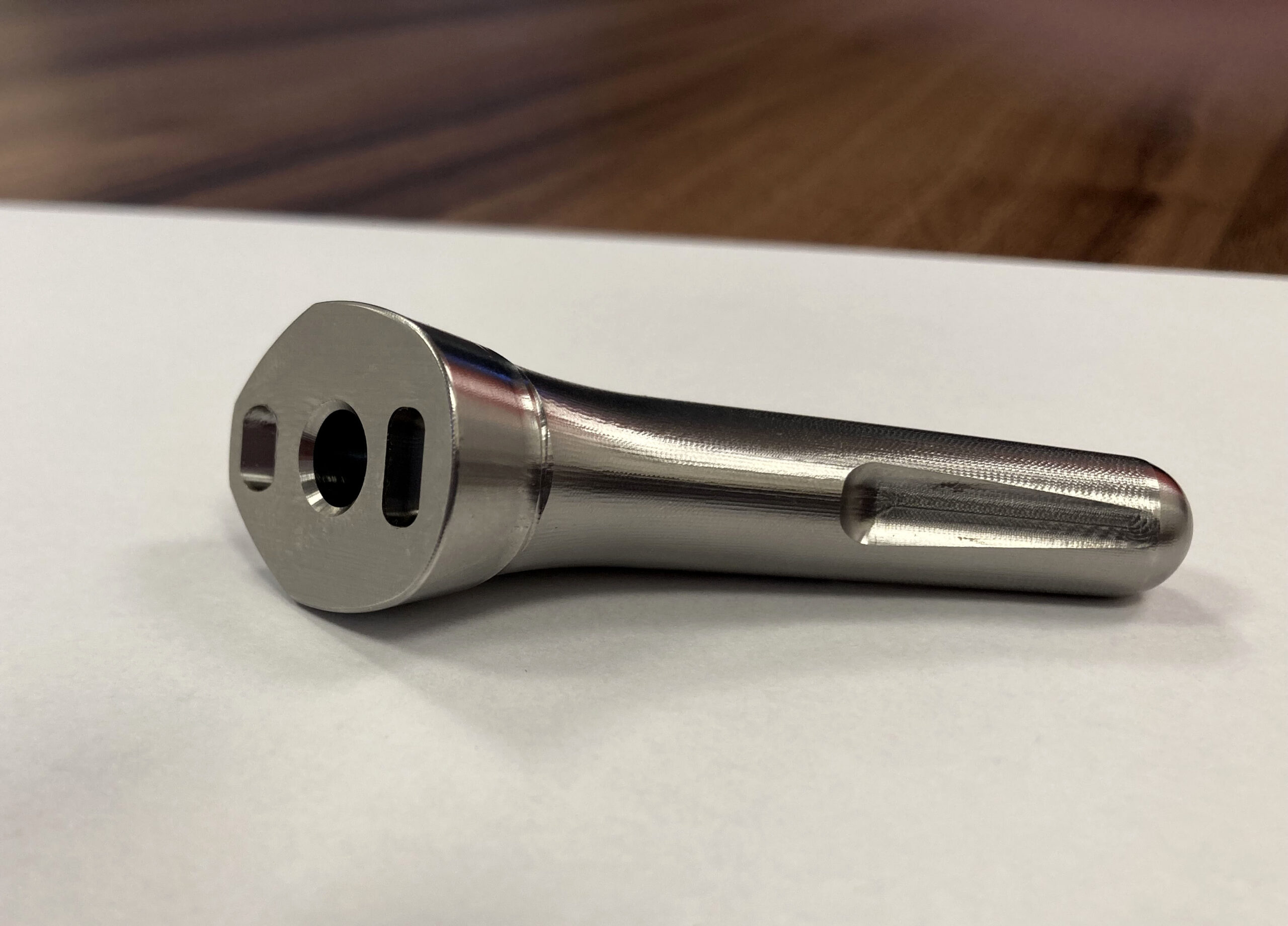

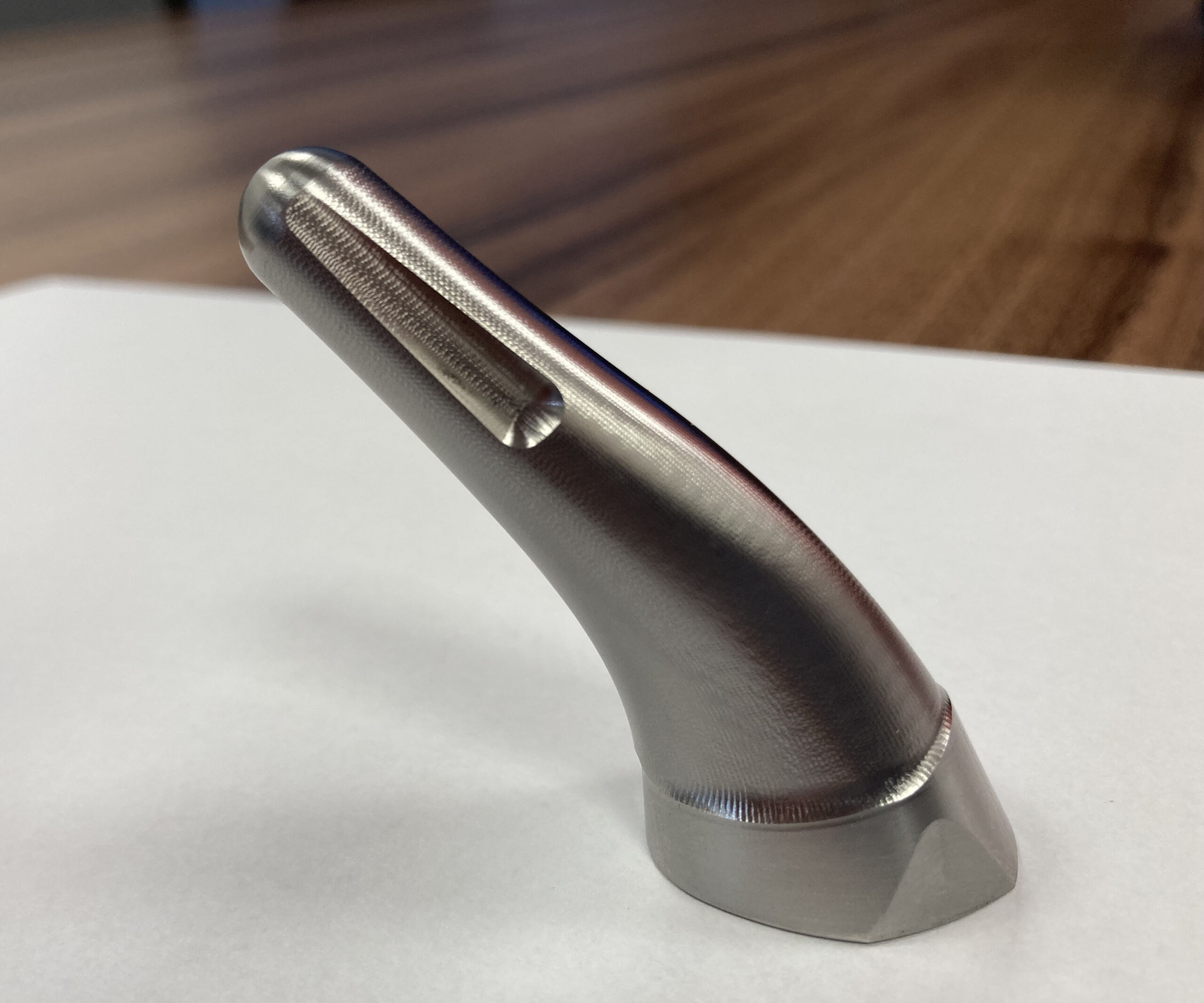

The part selected for the live machining demonstration is a shoulder implant – the stem-like component that goes into the humerus bone (upper arm). This implant is attached to another implant part, the humeral head, a ball-like structure at the top of the humerus which, during surgery, fits into the glenoid cavity (or socket) located in the scapula (shoulder blade).

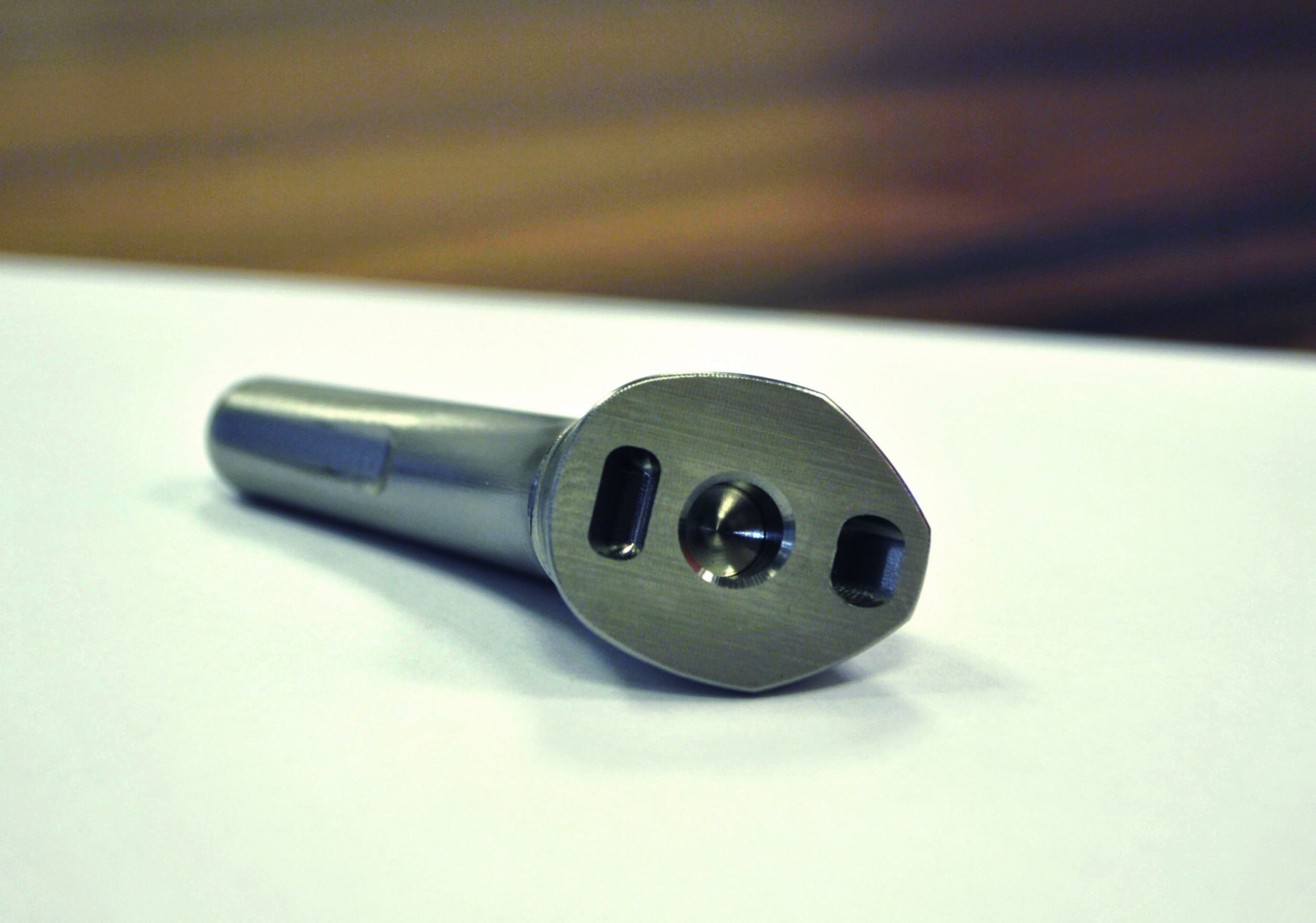

The stem component being machined on the SMX 2100SB is made from a solid titanium bar/billet with individual part dimensions being (approximately) 74mm in length and 50mm diameter. Total part cycle time is 45 minutes, and this includes all front- and back-end machining operations including parting-off and part transfer between the left and right spindles.
In addition to parting-off, other operations include roughing and finishing (front and back-end), OD profiling, slotting, face and side milling, 3-axis turning, 5-axis simultaneous milling, drilling, counter sinking etc.
