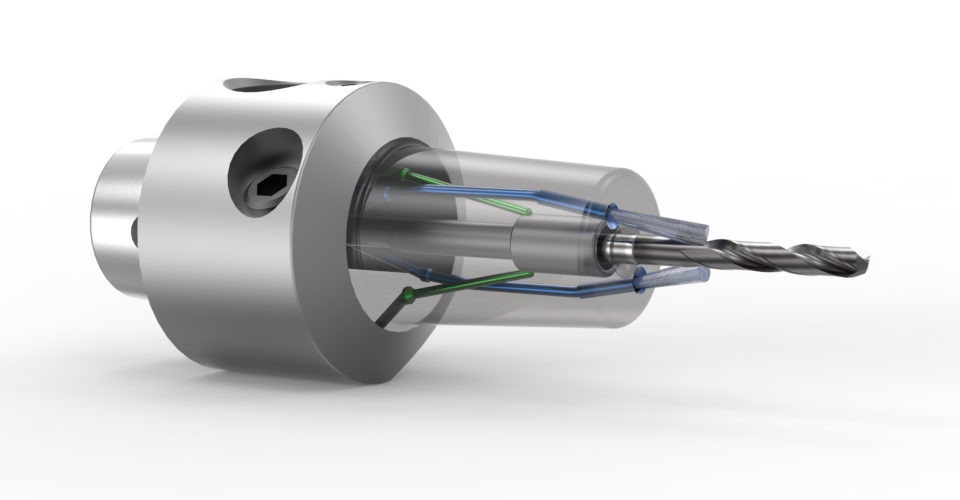

At MAPAL, additive manufacturing by selective laser melting is now used in all product areas. This is particularly the case in all situations where additively manufactured products can offer clear added value for the customer. Thanks to this innovative manufacturing process, MAPAL has succeeded in manufacturing clamping chucks in miniature format with the HSK-E25 connection for direct clamping of tools with a diameter of 3mm whilst meeting the challenging criteria mentioned above.
The smallest clamping chucks with the best properties
In order to guarantee radial run-out accuracy, the clamping technology specialists have integrated innovative clamping chamber systems into the new clamping chucks that fit snugly against the tool shank. They are equipped with dirt grooves to displace microscopic particles. The required balancing value is guaranteed thanks to internal balancing geometries including support structures that also optimise the weight and strength distribution. Overall, the small format chucks can achieve a more homogeneous and spindle-friendly acceleration and deceleration for the entire tool system that consists of the clamping chuck and cutting tool.
Thanks to additive manufacturing, MAPAL has succeeded in equipping the clamping chucks for the miniature sector with decentralised coolant outlets. Using parameters such as coolant pressure, setting dimensions and spindle speed, these optimised outlets are designed in such a way that they convey the lubricant directly to the cutting point.
