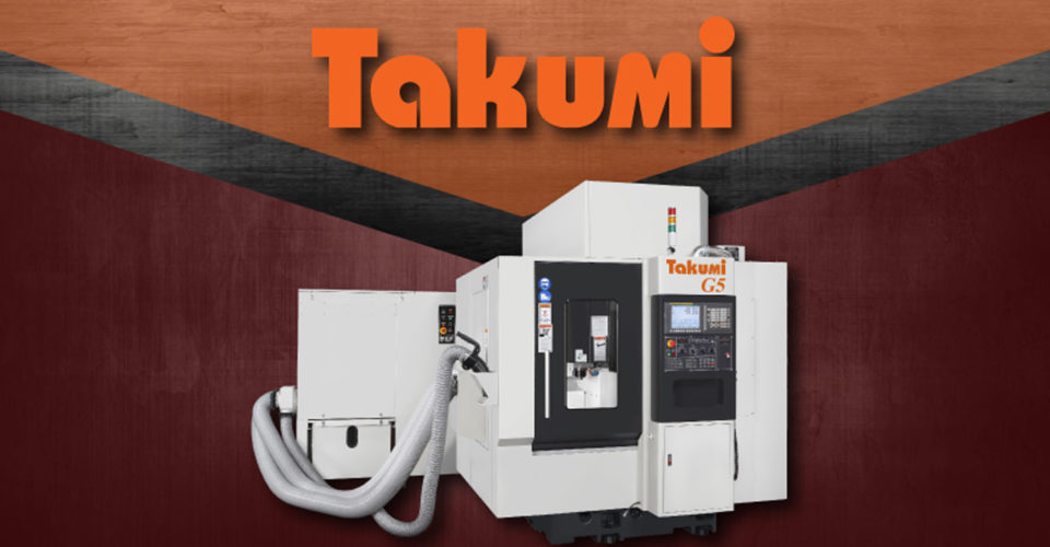

Takumi are based in Taichung City, Taiwan which has become a centre of excellence for technology, evidenced by the manufacture of machine tools and components for many Japanese machine tool companies. Takumi have been manufacturing high precision machine tools for over 30 years and, having established themselves in Asia, have expanded into Europe and the USA. Their product range includes vertical machining centres, 5-axis machines and bridge type machining centres, machines being available in many configurations to suit individual requirements and budgets.
The G Series of machining centres, comprising of three models, has been developed to cope with the aggressive environment created when machining graphite. Operator safety and protection is assured by a sealed work area and seamless telescopic covers, combined with a large vacuum system for evacuation of harmful particles. To minimise the interval between services and in order to prolong machine life, the ballscrews, linear guideways and spindles are of particle-proof design and manufacture. The built-in high power, high speed spindles have embedded automatic thermal compensation and a cooler to ensure high accuracy.
