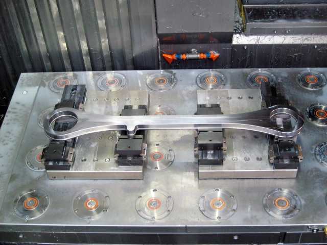

Leader Chuck’s ZeroClamp® zero-point clamping system is designed to significantly reduce set-up times and increase machining efficiency, the Patent-registered new system provides an effective route to producing more components, quicker and at a lower cost. Several features set this reliable and robust workholding solution apart from other competitor systems.

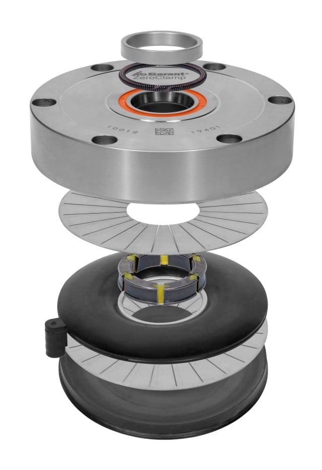

Using the face and taper HSK spindle tooling principle the Leader ZeroClamp® can achieve a repeatability of +/- 2.5 micron, around 10 times more accurate than existing systems. As the hollow, tapered-shank bolt is drawn into the clamping pot the elastic properties of the seating ring expand slightly, allowing the taper to locate positively and the faces of the pot and the pallet or raw material to engage and locate solidly. Subsequently each fixing point has a break-out force of between 12.5 kN and 60 kN, depending on the clamping pot diameter.
This principle also removes any machining induced vibration, minimizes all thermal effects and compensates for hole misalignments of up to +/- 0.1 mm as the tapers always compensate towards the centre of the clamping position. The tapered bolts are produced from case hardened 42CrMO2 steel and are very strong, allowing the workpiece or raw material to stand on them for storage. Only one design is used, avoiding the confusion caused by ‘fixed’ systems, which usually require three different bolt designs that are also known to magnify any thermal errors.

Another advantage of the taper bolt design featured on the Leader ZeroClamp® design is the ability to tilt the pallet or workpiece during loading and unloading without fear of damage, making heavy and unbalanced workpieces easier to handle. It also means the units can be fitted at any angle, so they can be used in conjunction with tombstones or similar fixtures on horizontal machining centres. By contrast fixed systems are often only used on vertical machining centres as they need to be lifted parallel or they can deform or lock together.
Fail-safe clamping is achieved on the Leader ZeroClamp® system by a stack of precision manufactured segmented spring steel collars that, by design, lock the taper bolt in. These collars are opened by an expanding bellows inflated with compressed air at standard shopfloor pressure. The bellows are guaranteed for 1 million operational cycles.
The simple design uses just a few high quality stainless or corrosion resistant steel components so it is very robust and is unaffected by swarf or coolant ingress, the pots can be quickly cleaned out with a blast from a standard airline gun.
