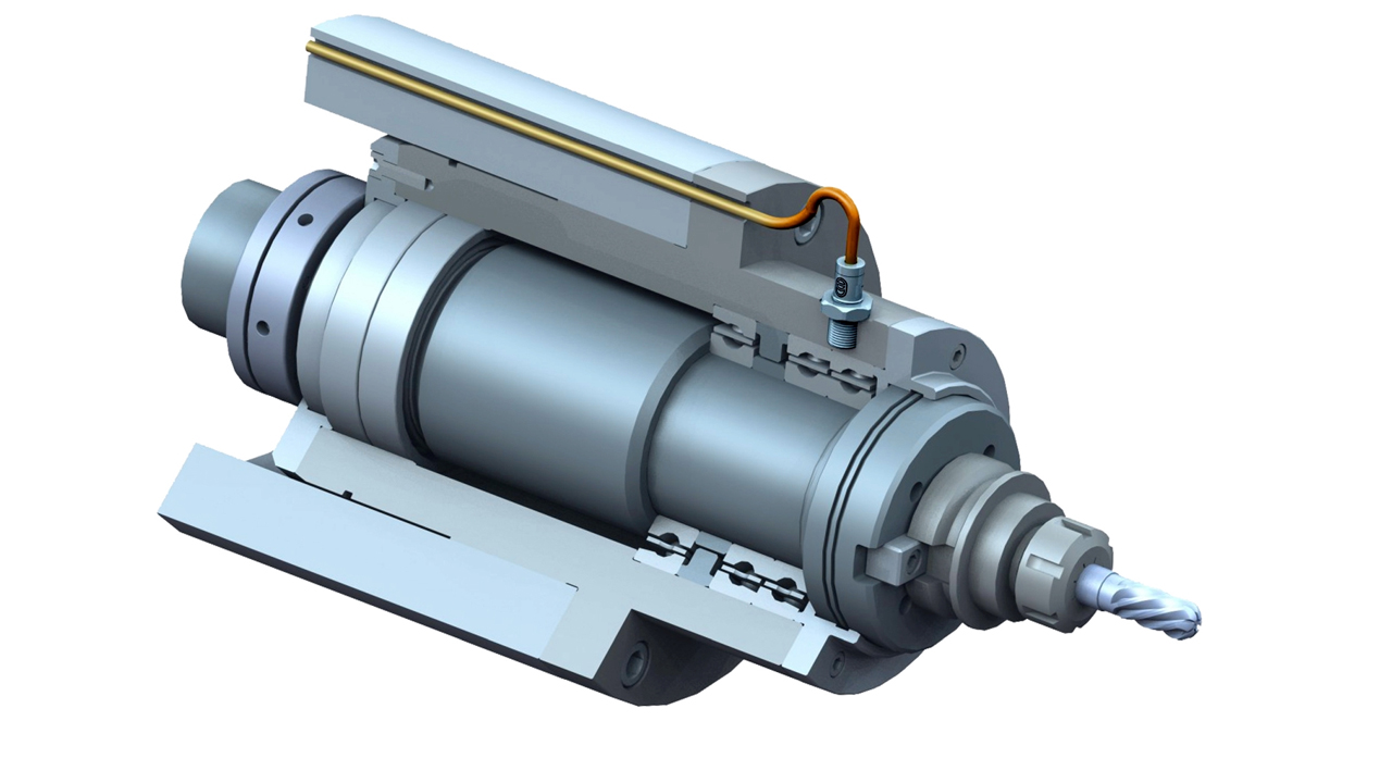

B-Safe is a new concept that supports the complete monitoring and diagnostics of spindles and machine tools using vibration and temperature analysis. The miniaturised system can be directly installed into any machine spindle guaranteeing a real-time monitoring of all anomalies, predicting malfunctions and safeguarding businesses by reducing the machine downtime.

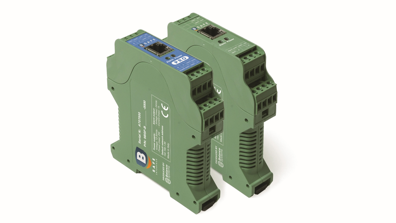

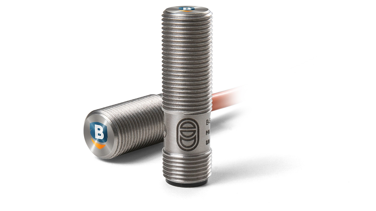

Comprising an advanced sensor, an interface switch and a user-friendly software platform, B-Safe can be easily retro-fitted to any machine tool. At just 12 mm diameter the sensor contains hybrid technology MEMS 3D and piezoelectric sensing to guarantee complete signals analysis on a wide band. The inclusion of a microprocessor with integrated memory allows local detection and on-board memory data logging of collisions, unbalances, overloads, anomalies of the working cycle, tool wear and bearing diagnostics. It provides evidence for predictive maintenance at a glance.
The software program provides a ‘dashboard’ where all the parameters and thresholds for the sensor can be set up, monitored and viewed over logged time, and any alarms can be investigated and fully analysed. The wide range of functions within the software allows users to manage the whole process with one single system.

Sensors can be specified in two formats, hardwired to an integrated 5 m cable or with a 5-pin connector, to suit the installation application. In either format the rugged sensor can reliably operate between -40 and +85 oC and is robust enough to withstand a 10 kg shock load under collision conditions.
