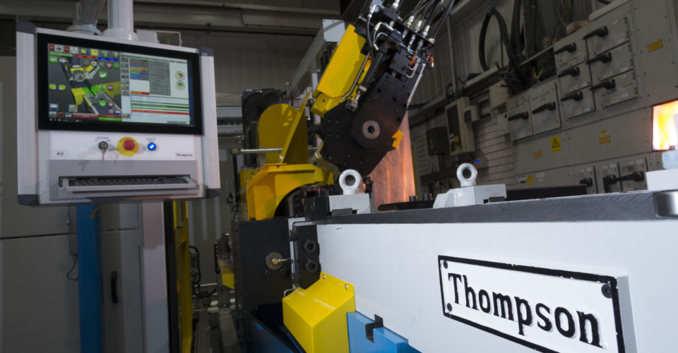

K: Why do our customers choose rotary friction welding, over traditional welding methods?
J: There are many advantages to rotary friction welding – A solid state joining process, RFW generates the strongest form of bond and supports 100% maximum repeatability of bond between materials. KUKA’s control software on a Thompson friction welding machine dictates that each weld is created using specific parameters, to ensure a 100% bond is created at every weld. Each weld is precisely monitored using quality control software which reduces checking and testing.
Rotary friction welding is a method used to join many different types of materials. There are many, many material combinations and KUKA is always willing to try new recipes as part of our ongoing development programme. With friction welding, there is no need for any consumables or external heat/flux. This also means friction welding is friendly to the environment creating no harmful fumes or gases.
Minimal preparation is required for friction welding. Using our pre-bond method, we can weld rough-sawn material as the rotary motion is able to prepare the surface during the bonding process.  The Thompson friction welding machines are equipped with automatic length control which means that every weld will result in the same length end-product, even after the weld burn off, minimising waste and providing a cost-efficient welding solution, delivering; short cycle times, providing overall unit cost savings; material optimization reducing material costs; dissimilar material bonds, reducing material costs.

K: What ad-hoc features can we adapt to a ‘standard’ machine, that make KUKA truly unique, as manufacturers of rotary friction welding machines?
J: KUKA can include many different options to a standard manual machine which can be unique for the customer: –
Fully automated welding cell, incorporating KUKA’s industrial robots and conveyor systems
Automated flash removal
Automated gas lance for internal flash removal of tubes
Bar code reader incorporated into the machine software for traceability
Weld orientation
Material length control
KUKA possess the expertise within our systems ‘arm’ to combine the KUKA and Thompson products, ultimately offering a full turn-key solution to customers, all conceptualised, designed and delivered under the KUKA brand. We also have the flexibility to design a system around the customers’ specific requirements.
