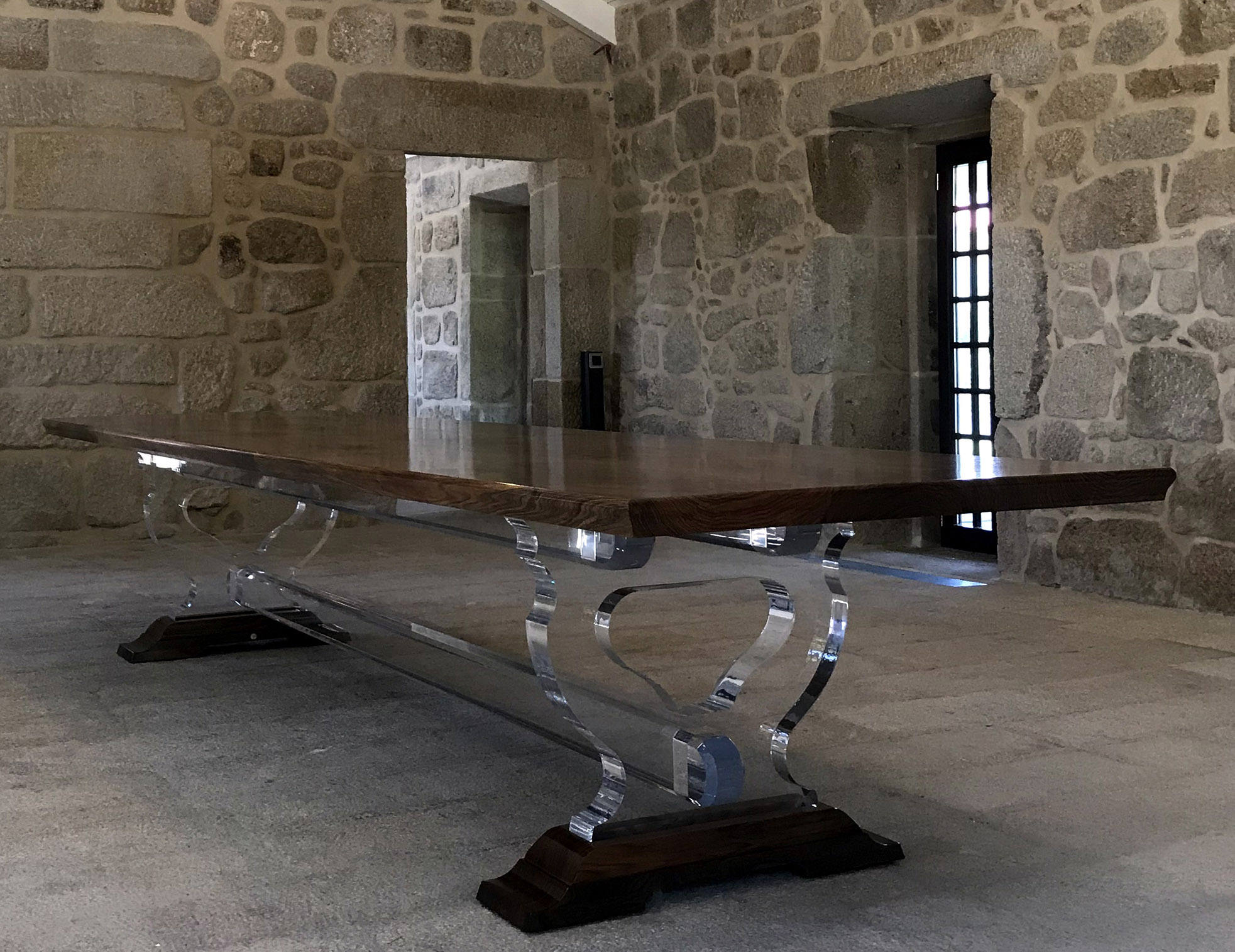

One recent ‘celebrity commissioned’ project for a 3m long table, was designed and produced in conjunction with Inplas, a company that knew that when it was faced with a seemingly impossible design brief, cutting tools from ITC would be the tool in its armoury to deliver success. With a design brief for a table manufactured from acrylic and walnut wood with no fixings, screws or adhesives, the visionary designer couldn’t find a manufacturing partner to undertake the project – until a Google search led the Cornish designer to Inplas.
A number of visits to West London to see Inplas and agree the profile shapes confirmed that the seemingly impossible feat of resting 200kg of Walnut on acrylic legs with no fixings was feasible. Sebastian spent nine months hand crafting the wood for the table and chairs while Inplas got straight on the phone to Sally Hunt at ITC.

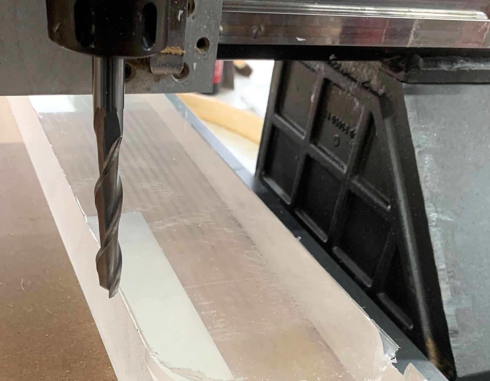

With more than £3500 of 80mm thick acrylic that needed machining as five separate parts, Inplas recognised the need for high-quality precision cutting tools capable of machining the 80mm thick material. Furthermore, with no fixings involved, the two stringer beams, the connecting stringer beam and the two legs needed a precision interference fit with a polished finish to fit together and remain sturdy – hence the call to Tamworth cutting tool experts ITC.
Commenting upon the project, Inplas Director Mr Trevor Smith says: The 3m long stringer beams slot into the top of the CNC machined legs with a 45degree bevel angle on the corner of the exposed beam. We knew we needed specialist cutting tools and technical support, so Sally at ITC was our first call. The first issue we had was the thickness of the acrylic. It meant we needed a cutting length of at least 80mm and we wanted a balanced tool for optimum surface finish and precision. Sally at ITC supplied a specially modified 2631-12 Series 2-fluted extra-long end mill with additional necking to provide us with 80mm cutting length plus an additional 5mm clearance.
With the cost of the acrylic and the impeccable finish and precision required, Inplas decided to conduct a trial run on an 80mm thick MDF template. “ITC supplied the special tool in just a couple of days and on our MDF trials, Sally was on hand to advise regarding the cutting parameters such as speeds, feeds and machining strategy. The trials went perfectly, and we then had the confidence to machine the acrylic components for the project. We use a number of cutting tool vendors including ITC for general tooling, but when it comes to special projects, ITC is always our first port of call. The quality of the cutting tools is exceptional, but equally important is the technical support. If we have a new project that throws-up challenges from a machining perspective, we will always seek out the advice of Sally from ITC. We have been using cutting tools from ITC for a number of years and the technical support has always yielded benefits for our business. Whether it is productivity gains, extended tool life, surface finishes or the requirement for special tools, ITC has always been there for us.”
The five acrylic components for the table required more than 15 hours of machining with an additional 85 hours of hand polishing. Commenting upon this, Trevor continues: “We only needed a single 2631-12 Series 2-fluted extra-long end mill ITC tool for the entire 15 hours of machining and the performance was consistent throughout. This performance highlights what is possible when you combine high-end machine tools and high-quality cutting tools.”
