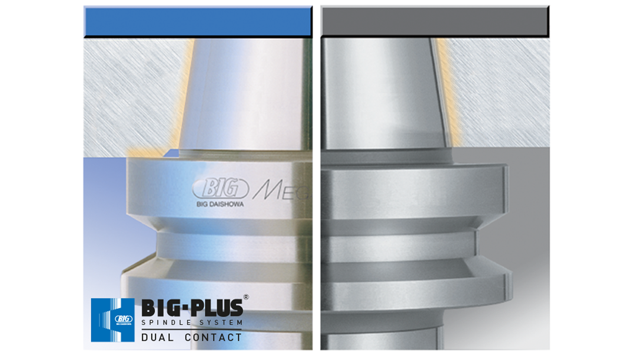

The BIG-PLUS solution available from Tamworth cutting tool specialist ITC is unique and provides substantial advantages over competing industry spindle designs. It is the only system that provides simultaneous taper and flange contact in a 7/24 cone interface. This dual-contact connection between the machine and the tool makes it exceptionally robust, reliable and accurate.

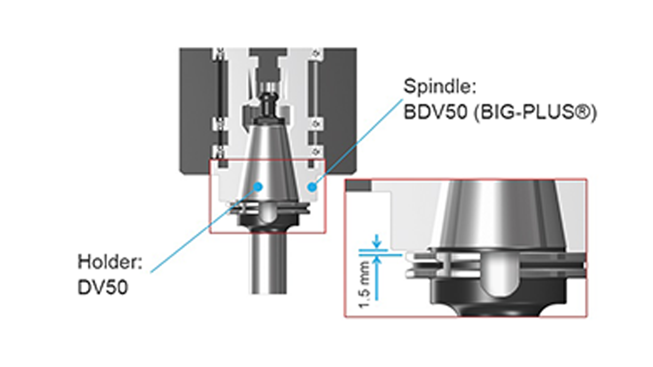

For customers who are unsure whether they have a BIG-PLUS spindle, the easiest way to check compliance is to place a standard tool into the spindle and see how large the gap between the tool holder flange face and spindle face is. On machines without the BIG-PLUS system, the standard gap for DV50 should be clearly visible at approximately 3.2mm. With a BIG-PLUS DV50 spindle, the gap is approximately half the size. Naturally, gap sizes vary accordingly for DV40 and DV30 configurations. Nevertheless, with BIG-PLUS the gap is always visibly smaller compared to alternative spindle interfaces. Alternately, manufacturers can ask their local ITC representative to confirm compatibility.

The BIG-PLUS solution ensures that as the tool enters the machine spindle, the taper makes the initial contact. Due to the pull-in force, the tool taper expands the spindle in the elastic range of the steel. The tool is then pulled further into the spindle until the tool flange reaches the surface of the spindle nose. These tool holders are firmly held to a fixed relationship between the gauge line and the face with a tolerance of only a few microns. With such a tight tolerance, BIG KAISER can be sure that any BIG-PLUS tool put into any BIG-PLUS spindle will have the proper taper and face contact. Having the same dimensions as conventional BT or SK holders; BIG-PLUS is fully interchangeable with existing accessories. To benefit from the huge benefits of the BIG-PLUS system, please contact ITC to confirm compatibility. If your machine tool is BIG-PLUS compatible, ITC will undoubtedly have the tool holding and clamping solutions to drastically improve the productivity, precision, surface finish and tool life benefits of your business.
