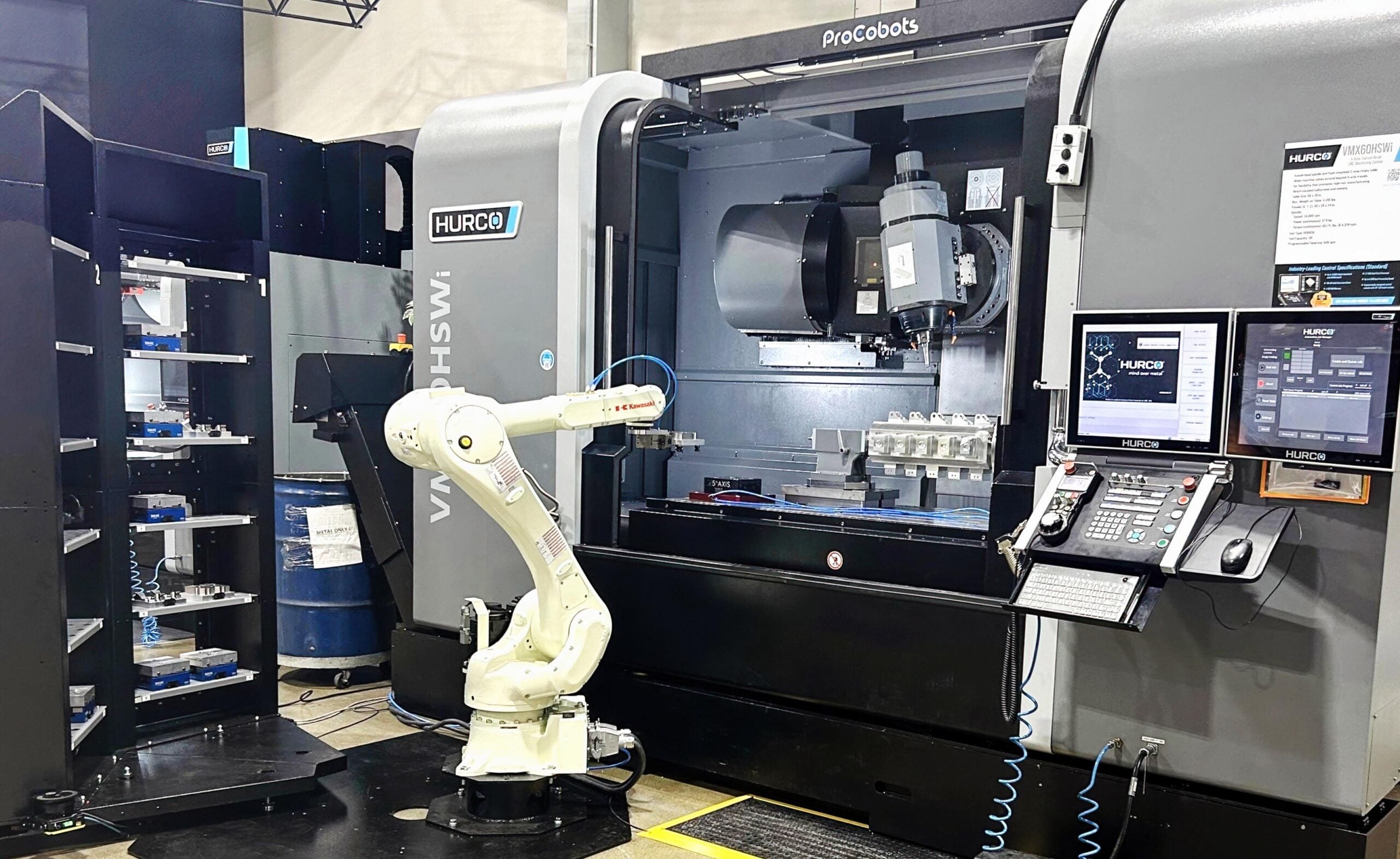

On the stand will be Hurco’s first-ever machine tending cell based on a 6-axis industrial robot, which will be offered as a standard package. It will comprise a cantilever-design 5-axis VC500i machining centre equipped with a Kawasaki PC 25 system. It is the first offering to result from the strategic collaboration between Kawasaki Robotics and Hurco that was announced at IMTS 2024. The cell is an automation solution that combines the additional load-capacity of an industrial robot with easy-to-use, app-based programming at the Hurco control.
The flexible solution allows various pallet, fixture and component combinations weighing up to 25 kg to be delivered to the machine from the heavy-duty rack system. In addition to long production runs, the solution lends itself ideally to the automation of one-offs and small-batches. As the robot is programmed with the same user-friendly Hurco software as is used for the cobots, less than one day’s training is required for an operator to become proficient.

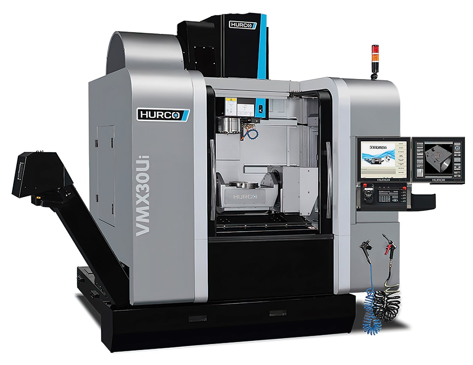

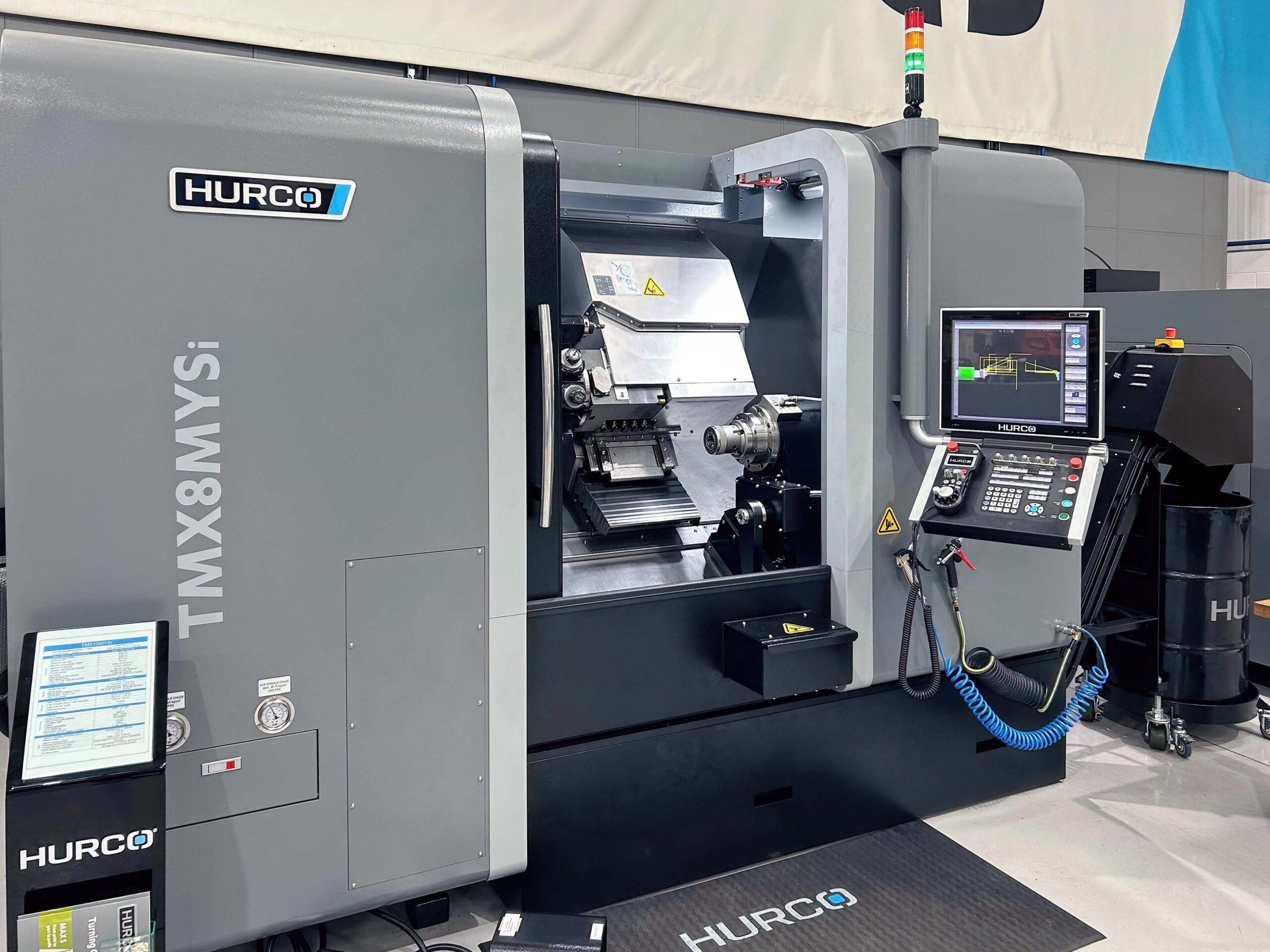

Hurco will also be showing a VMX30Ui trunnion-type 5-axis machine and a pair of 3-axis vertical machining centres, a VM10i and a larger VM20i automated with a ProCobot Profeeder-X 10-drawer system. CNC lathes, which are a growing part of the company’s turnover, will be represented by two driven-tool models, a TM8Mi and a TMX8MYSi, the latter having Y-axis turret motion and a sub spindle.

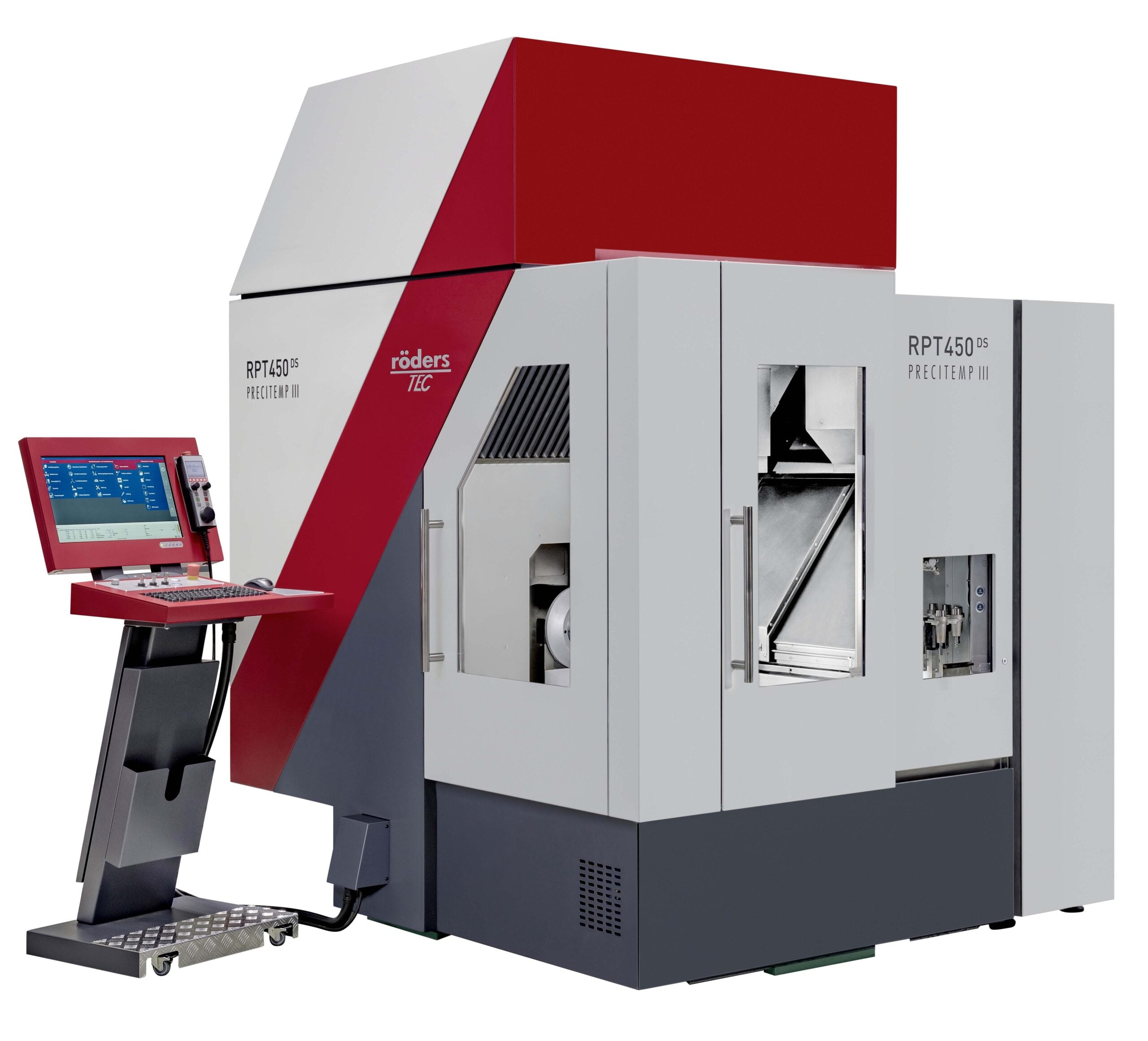

Under a long-standing agency agreement that has spanned more than 20 years, Hurco Europe has been the exclusive sales and service agent in Britain and Ireland for 3-axis and 5-axis, high-speed machining centres built by German firm, Roeders. To be exhibited for the first time in the UK will be the RPT450DS EcoSpray, a 5-axis machine capable of milling, jig grinding and measuring. It is able to maintain super-high precision even under variable ambient temperature conditions.
The DS suffix signifies dual support for the swivelling of the rotary table, providing superior stability for 5-axis simultaneous machining, while EcoSpray refers to a patented tool cleaning and minimum quantity lubrication system integrated into the machine.
It will be the first time that any premium line machine from the Roeders RPT range will have been on show in the UK. While the established RXP series was already world-class, the new series features Precitemp technology designed to halve the achievable tolerances, moving from micron-level precision into the sub-micron and nanometre realms.
