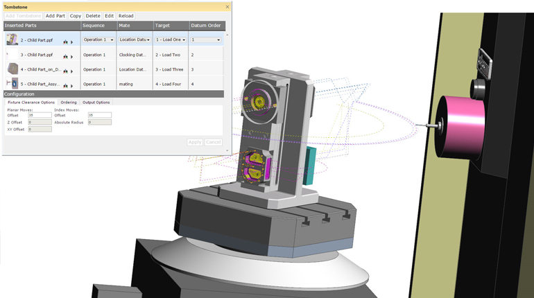

Edgecam Brand Manager John Buehler says every user will benefit from at least one of the enhancements…the most significant of which, has been a complete transformation to the Tombstone Manger, thanks to 13 enhancements.
The new ‘Add Tombstone’ function ensures users never overwrite their master tombstone assembly file (referred to as ‘Seed file’). The originating file is always protected, guaranteeing that vital information is never over-written.
The number of components that can be inserted onto the Tombstone is now limitless, reflecting best industry practice. Once inserted, the toolpaths are not only automatically merged, but the enhanced ‘Closest Next’ ordering further economises the CAM toolpaths.
“Arguably the most significant individual enhancement is the ability to retrospectively edit the CAM toolpaths,” he says. Using the new ‘Edit’ and ‘Reload’ functions, Edgecam will independently open the inserted file allowing the user to perform unlimited edits to the CAM instructions. Once finished, the seed file is automatically updated with the new editions.

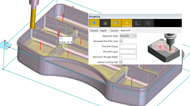

Pre-Drill Approach Roughing Cycle
The way the ‘Pre-Drill’ approach strategy is handled, has been significantly improved within the Roughing cycle. “Rather than manually create drill hole positions, which is sometimes time consuming, Edgecam 2018 R2 automatically creates the hole position and keeps the drilling toolpath associative to the Roughing cycle.
“Simply by activating the command, users can deploy the multi-level and depth functions within a hole cycle, to automatically locate the best entry position for the drill cycle.”

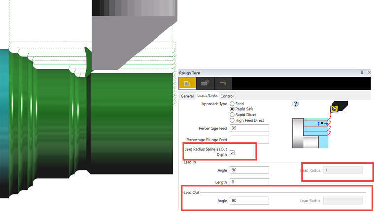

Extended Lead Parameters Rough Turn Cycle
The Rough Turn cycle includes several new lead parameters allowing the user to roll in and out of each cut with a tangential arc. A bi-directional toolpath can be created, allowing the cycle to be used in conjunction with Sandvik’s CoroTurn® Prime turning inserts. Significant time savings and reduced tool wear can be achieved when adopting these methods.
Also, the cycle’s collision detection capability has been extended by automatically removing any potential crashes between the tool and the tailstock.

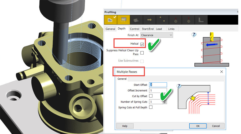

Profiling Cycle performance and functionality improvements
Through improvements in the toolpath algorithm, Edgecam 2018 R2 provides a significant performance improvement with the ‘Pick Solid Faces’ function. Time savings of over 50 per cent can be achieved thanks to the manner in which the cycle gathers data for toolpath calculation.
“Users will also gain further benefits when using the Multi-Pass function as the strategy is now supported with helical capability,” says John Buehler.
