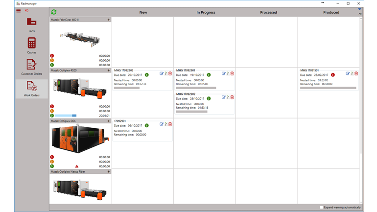

“Radan isn’t just a CAM system any more. It plays an important role in ensuring sheet metal manufacturers are best placed to run with Industry 4.0.” An example of this is with Radmanager. The system now accepts feedback from the shop floor regarding the cutting progress. “This improved connection between the shop floor and logistics operations means the stock management and order processing functions can immediately update the stock control.”

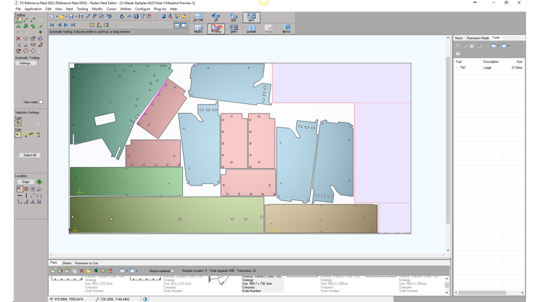

The profiling function benefits from six updates. Firstly, hatching, where laser users can now create fine marks to identify parts. Olaf Körner says it can be any shape, such as a bar code design, text, or a number, and is simply “hatched” on to the metal with the laser. Enhanced flycutting, where the machine doesn’t stop during an entire operation, reduces cycle times; the lead-in placement for tagging has been optimised; additional support for automatic filleting means users have much greater control over where they are placed…they can be switched on for one part and off for another, and whether they are on internal or external corners. Radan developers have worked closely with plasma cutter manufacturers on additional support for cutting circular holes with higher accuracy on plasma CNC machines. And following the contours of a part when creating offcuts saves more of the material, reducing wastage even further.

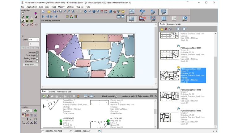

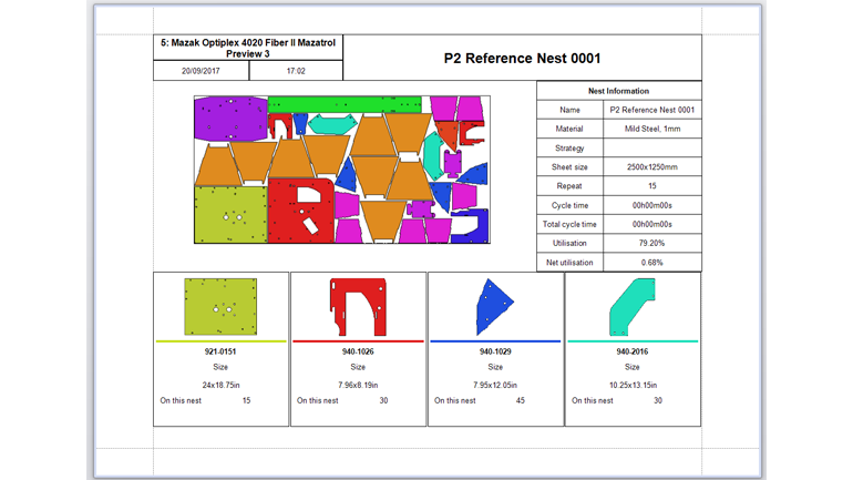

A new batch nesting system is described as a “big performance upgrade,” which forecasts show could improve material usage by around nine percent over a year. A new algorithm provides a different approach to optimising a range of nests. “The software now looks at the entire nest run and reduces the number of overall sheets instead of focusing on how full each individual sheet is.”
