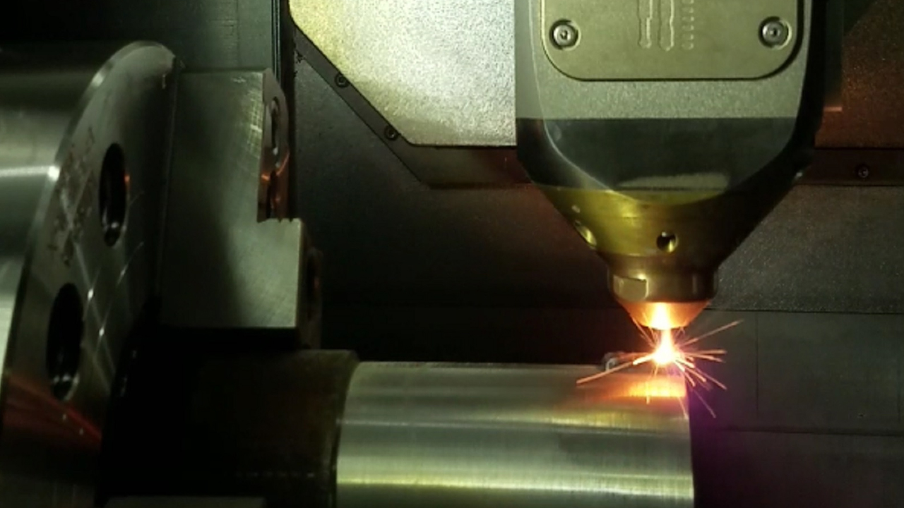

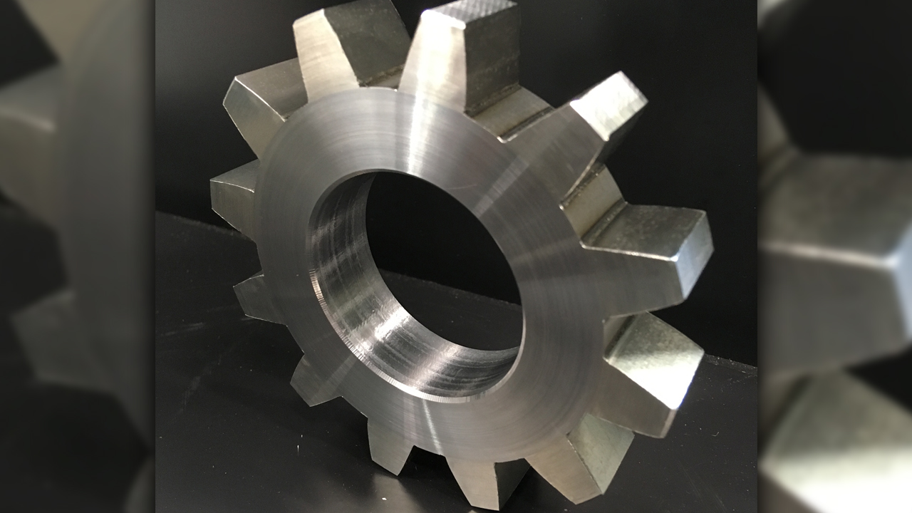

Mazak says visitors to its latest Open House event were impressed by a showcase demonstration of  Edgecam software programmed on the INTEGREX i-400AM 5-axis Hybrid Multitasking machine tool. The machine was manufacturing a hybrid gear by depositing as well as machining different materials tooth by tooth.
Supporting the Directed Energy Deposition method, Edgecam now offers a dedicated manufacturing cycle which accurately guides a laser, as it deposits material to form a shape. After the deposition process is conplete the shape is machined using Edgecam’s milling cycles to create the final component. Shapes can be built using almost any milling cycle.
Mazak’s Additive Manufacturing Technical Specialist, Woody Darlington, says the near 500 visitors were particularly impressed with how the seamless switch between depositing material and machining provides an economical, innovative solution, saving material costs, reducing waste and inventory time.
“This process enables parts to be repaired and remanufactured, as well as produces hybrid material components with enhanced performance and longevity. Using Edgecam on this Mazak machine tool means 5-axis toolpaths can be produced very quickly, saving considerable time for manufacturers.”
The demonstrations showed three different combinations of producing a gear tooth:
•    Stainless Steel
•    Inconel
•    Tungsten Carbide Nickel Matrix

“The additive lace cycle means Edgecam accurately guides the laser, depositing material to form the gear tooth shape, after which Edgecam’s milling cycles created toolpaths to create the final machined tooth.
