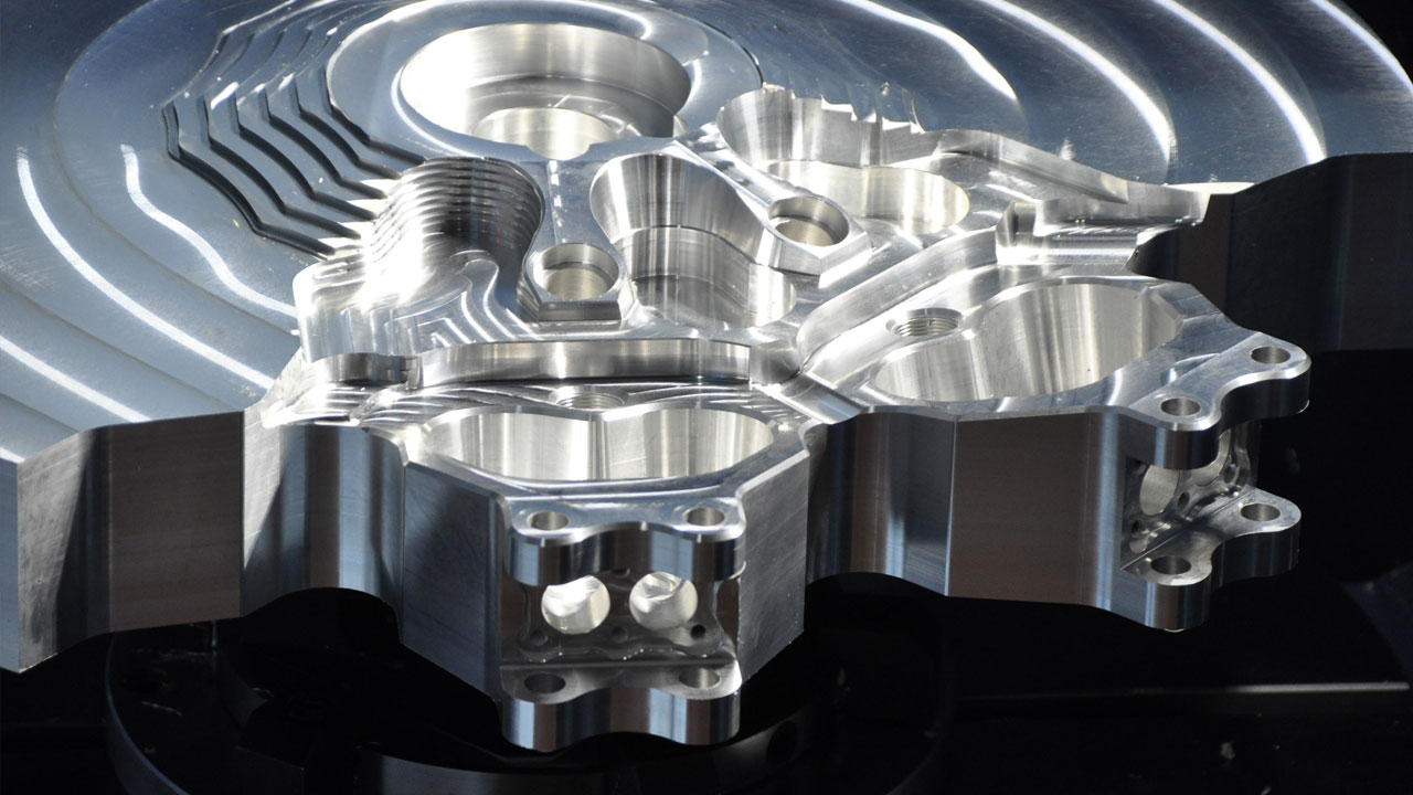

DMG Mori CTX machining demonstration of a flange, programmed by Edgecam:
The actuator being machined in this demonstration has gone through a process improvement programme, as the customer wanted to improve the existing process to reduce cycle times and production costs. This required a total re-engineering of the machining process.
Cycle times have been cut by 43 per cent, and production costs by 32 per cent. The demonstration showcases the optimised machining, highlighting issues that occurred, and how they were overcome.

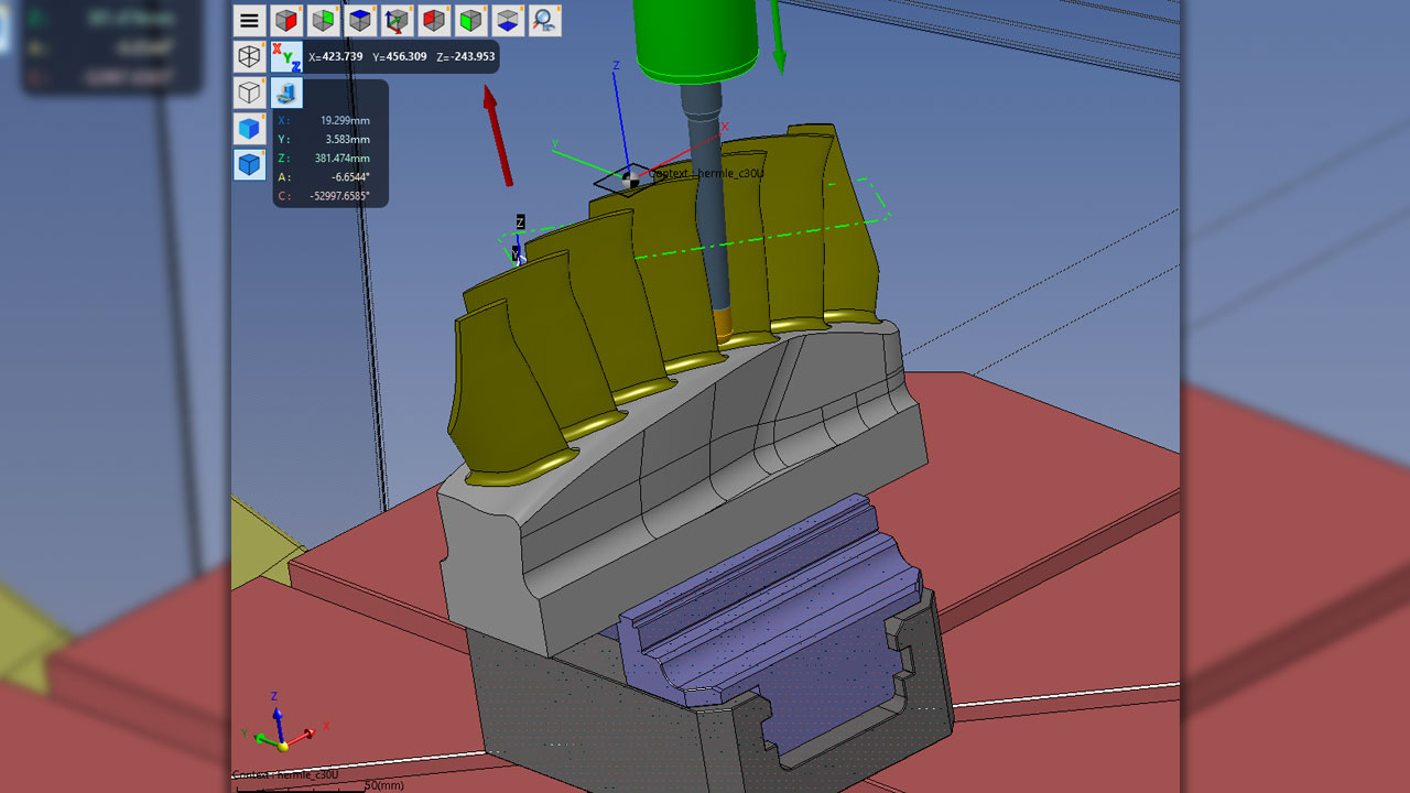

Hermle machining demonstration of a blisk aero blade, programmed by WorkNC:
Traditionally, jet engine compressor fans are produced with a single disk and multiple renewable blades. But multi-axis machine tools and latest programming strategies men that blisks can be manufactured – these are components where the disk and blades are machined in one piece.
Manufactured from titanium or nickel-based superalloys, aerospace blisks present a number of challenges due to the nature of the material itself, and complex, difficult-to-machine profiles. This demonstration highlights WorkNC’s latest roughing strategies which optimise cycle time. These include ‘lens milling’ the side wall profile, to deliver a significantly improved surface finish compared to the results of a typical scanning finishing strategy.
