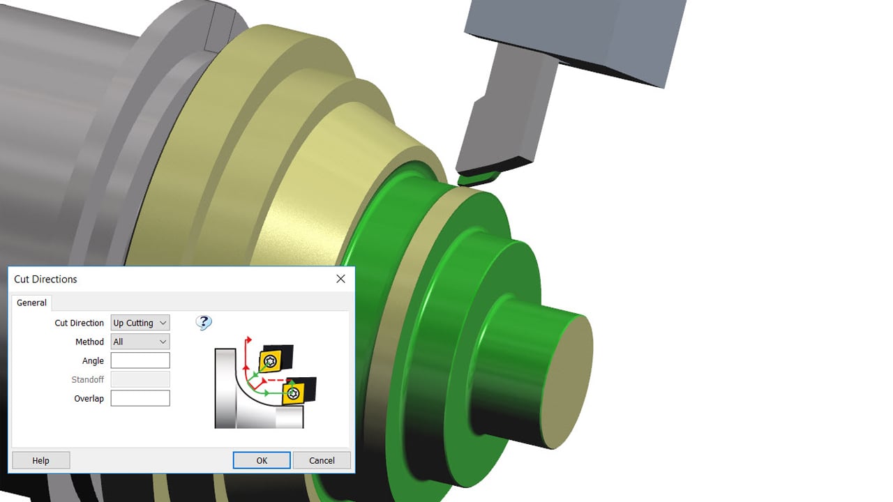

Finish Turning Cycle Support For CoroTurn® Prime Inserts
Again, for turning customers, a new Up-Cutting function has been added to the Finish turning cycle. This enables high productivity finishing to be achieved in conjunction with Sandvik Coromant’s CoroTurn® Prime tools and inserts.
Located alongside the Down-Cut modifier, Up-Cutting reverses the direction of the toolpath, to utilise the Prime insert geometry. Also, the cycle feedrate can be expressed using the ‘Chip Thickness’ modifier, as well as in the traditional format of feed per revolution.

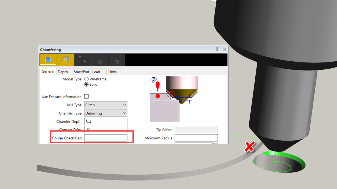

Chamfering Cycle Gouge Checking
Gouge Check Gap has been added to the Chamfering Cycle to give even stricter control over the toolpath. Specifically, neighbouring features which could potentially come into contact with the flute of the taper tool, can now be excluded.

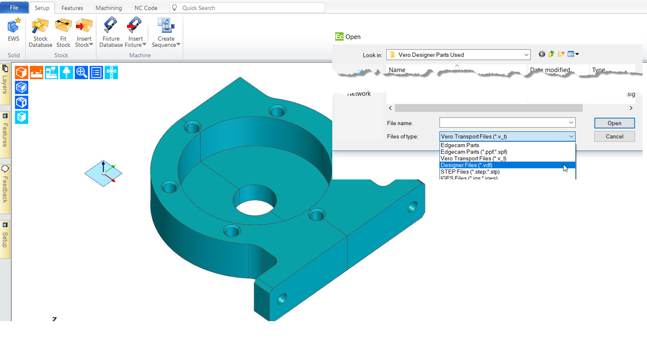

Extended CAD Format
Edgecam 2019 R1 supports the latest version of all CAD files. “Focusing on a few formats, users will notice, for instance, support for SpaceClaim 19 (ACIS V28), Parasolid version 30.1.247, Inventor 2019, and Creo 5.0. All other CAD formats will be catered for when a newer version becomes available.
“It’s particularly exciting that regardless of which licence a user has, they’ll be able to load all Designer files – *.v_t and *.vdf extensions. Designer is Vero Software’s latest CAD package, featuring direct modelling technology. This will be a major boost for manufacturers who haven’t yet sampled the power of Edgecam’s Solid Machinist capabilities.”
